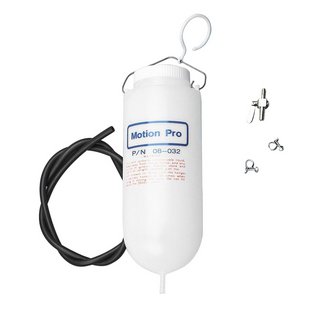

I have a remote tank that looks just like that one. I bought it, the adjustment tool shown and a set of mercury columns at the same time. That was 25+ years ago and I'm still using them regularly. I bought the mercury columns instead of the guages because there are no moving parts/never wondering if a guage is accurate or needing calibration.
I had thought about making one out of an old cylinder shaped lawnmower gas tank back then but I'm glad i bought the plastic tank because its easy to see the fuel level.

i have 2 of the motion pro aux. fuel tanks. they still get used and I've had em for many years.

This isn't the greatest, but it works.
[IMG]image - plastic lawnmower tank w fuel barb[IMG]

thanks guys i will buy the remote tank and be done with it

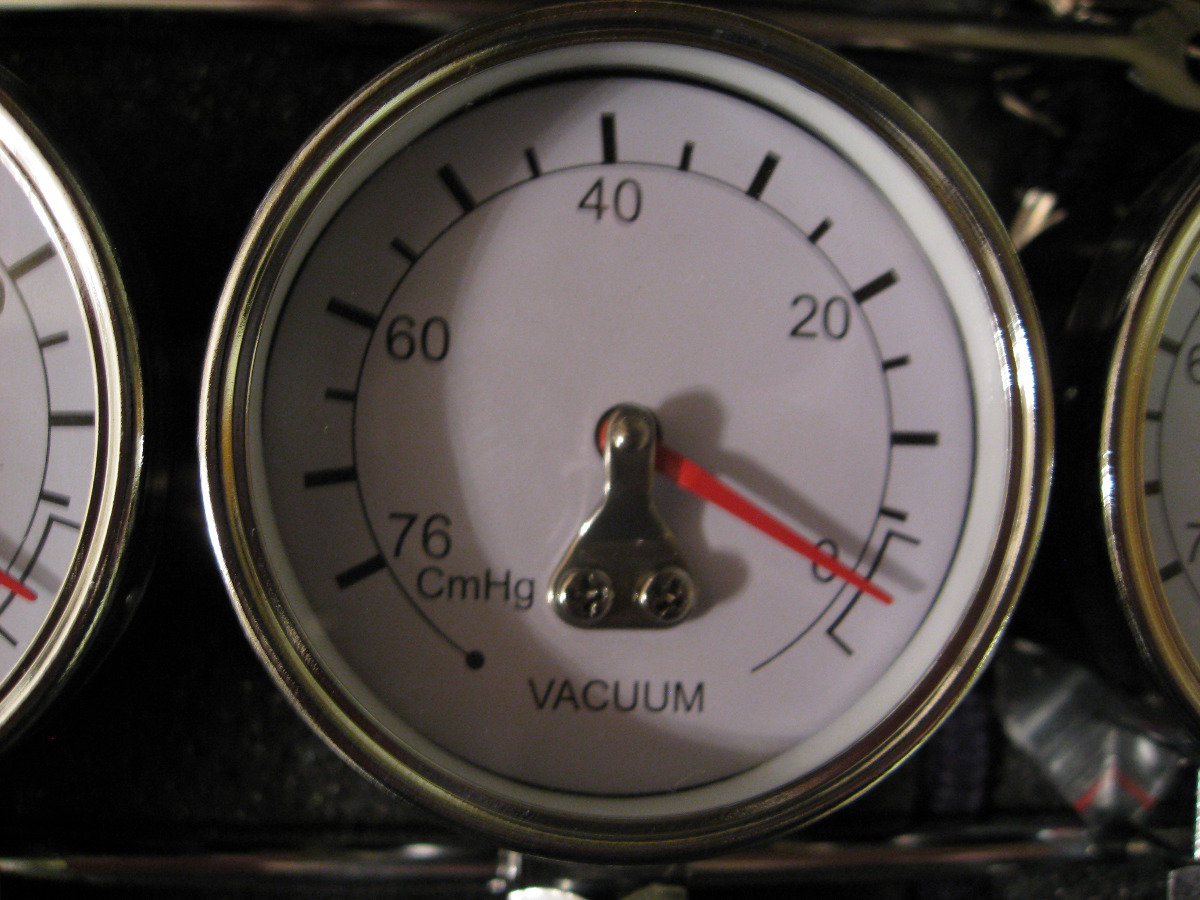

From what I can tell they look the same. Here are pics of mine...
Attachment IMG_0891_2013-01-29.JPG not found
Attachment IMG_0888a_2013-01-29.jpg not found

I bought the first Vac set, POS in the results.. compared to the Morgan unit, well there isn't a comparison!...
Seriously Craig, spend the extra $30 over the cheap set or ~ same $120 as 2nd set and go with a Morgan, you won't be disappointed...
Fuel tank, I use my KZ tank on a portable bench I have but this would be the way to go, hang off a vertical rise, handle bar etc...

I am a cheap guy so I used an old lawm mower fuel tank. Holds about a gallon of gas, I wrapped a clothes hanger around the middle then attached a bungie chord to the hanger. I just used an old in line petcock I had laying around to turn the gas on and off.
