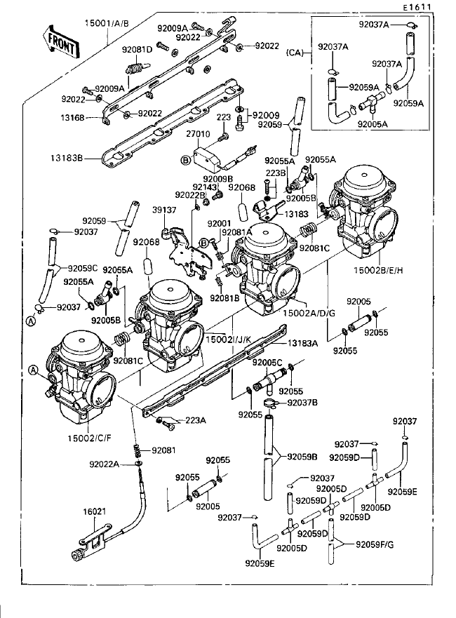

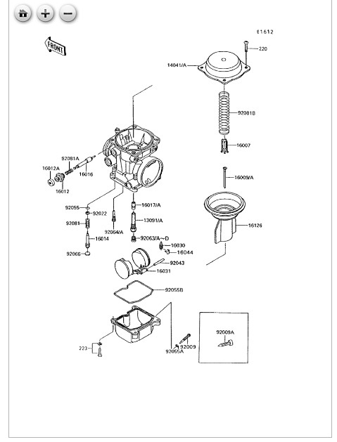

Either the parts fiche is wrong, or someone added the overflow tubes. Here you can see No Tubes coming up from the bottom of the float bowl. Other Keihin models do have the tubes and the bowls can be fitted to your carbs.

For whatever reason -- unknown to me -- sometimes the carb parts diagram on kawasaki.com doesn't show overflow tubes, but the carb assembly diagram may show overflow tubes.
Where overflow tubes are fitted to carbs, the float bowl in the carb parts diagram imo ought to depict a slim brass overflow tube inside the float bowl.
And where carbs have no overflow circuits -- overflow tubes aren't fitted -- the float bowl diagram would imo not depict a slim brass overflow tube inside the float bowl.
Here's the carb assembly diagram:
Without being positive, would surmise from the carb assembly diagram that stock carbs on the bike at hand would have overflow circuits.
