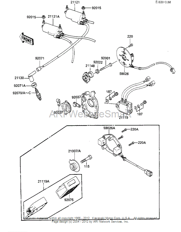

On my bike there's one hose on each side of the engine. I'm talking about parts number 7 on this picture:

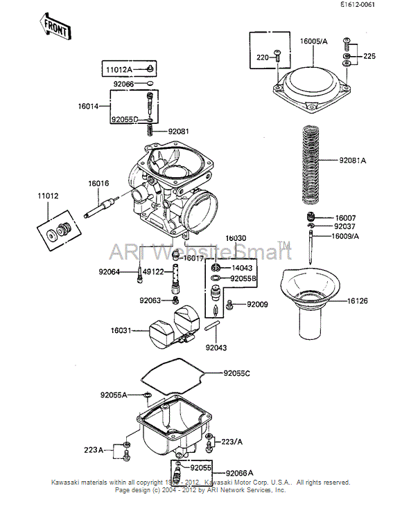

Also look at the vacuum system you posted, check the small vacuum lines, running from the two outside carbs into the Tee, going to the Air Valve. You can disconnect it, and plug off the small ports on the manifolds with caps. Then check the Line from #2, thats the one on the Left side one in, the line goes to the Vacuum petcock, make sure it is good.

When you tell me I can cap off the vacuum lines, you're saying I would cap off them off directly from the carburetor? The picture below is where I'd assume I'd be capping off.
