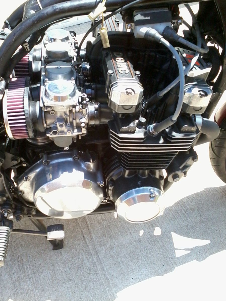

I love mine they were for a cb 650 gona have to rejet but on my bs 34s the breathe a lot better than my emigo pods did and its washable. Have noticed a bad cross wind lean out but hopen rc car filter oil is thicker and will choke them down a bit so the wind don't blow threw as bad

ready2ryde1985 wrote: I love mine they were for a cb 650 gona have to rejet but on my bs 34s the breathe a lot better than my emigo pods did and its washable. Have noticed a bad cross wind lean out but hopen rc car filter oil is thicker and will choke them down a bit so the wind don't blow threw as bad
Nice looking motor. B)

That is just what I am going for, ready2ryde. I wonder how the fitment for those BS-34's compares to the fitment for the VM26's. Looks like you have a good fit there.
