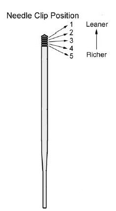

Imo, 5th notch is likely raising the tapered jet needle too high out of the needle jet, and thereby producing an excessively rich fuel mixture. 4th position could be an improvement, and the middle position might be best. Recall that mid-range is governed largely by the jet needle position (as set by the notch clip); and that this interrelates with the fuel level.

the needles are currently on the third (middle) notch, would the 5th be closer to the blunt or tapered end? Also, spudbuddy is running vm22's, while i'm pretty sure mine are 24's. Should I leave the jets as is? right now they're 15 pilots and 102.5 mains. I've got the carbs off the bike now and just ran out of carb cleaner so I'll need to pick some more up over the weekend, I couldn't smell any fuel in the oil, and what exactly do float levels affect other than not dumping fuel into the engine and how far off can they be before they start affecting performance?
