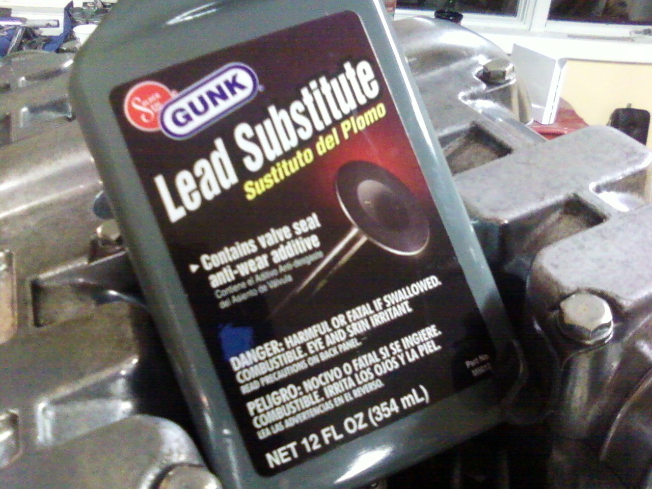

The bike is a few days away from being fired up and I'm going to try some of this stuff unless you guys can talk me out of it.
Last time it was running you could get gas with lead in it and it and she really liked it.
I could put 89 octane gas with lead in it and the engine would purr , put some unleaded in and I could hear pinging and knocks, didn't matter what octane.
actually I think the higher octanes made it worst.
Any thoughts ?

I used a similar "lead substitute" product for a lot of years. I think it's better than nothing.
Now I use this stuff which contains real tetraethyl lead:
www.batterystuff.com/fuel-treatments/OS6q.html
don't use it with any engine which has a cat converter.

29 Mar 2012 03:08 - 29 Mar 2012 03:11I actually bought it to get the lead which helps lube the valves. My bike never ran right on 87 octane, runs sorta OK on 89. So I buy 87 and add a few ounces of the booster which kicks it up to about 90. If you are getting knocks and pings, you have an octane problem which could be timing or something else.bluej58 wrote: I remember you saying you used that octane booster before and that's what gave me the idea of finding the lead additive , but I'm not sold on more octane because she runs good on less.
I just want to eliminate the knocks and pings.
A few years back, I was getting the booster for about $100 (delivered) for 12 quart bottles. The price has about doubled, so I won't be buying anymore. Every time Big Oil jacks the price of gas, the boosters get jacked too.

I'm thinking Kawasaki built these engines for lead free gas. Roy

29 Mar 2012 07:46roy-b-boy-b wrote: I'm thinking Kawasaki built these engines for lead free gas. Roy
They did. Kawasaki saw the 'writing on the wall' in the early 1970's, just prior to the lead-free transition.

Yep, I had a specific discussion with LarryC about how hard the valve seats are in these heads. We were discussing the use of carbide cutters and how long they will last. Particularly on the exhaust seats. Leaded fuel is not necessary. Knocks and pings are signs of pre-ingnition IMO. Can be compensated for by fuel octain or timing adjustment. Could also be signs of carbon build up in the comustion chambers.

Never heard it when I was running leaded, only on the few time that I ran the unleaded :huh:
I do have a little problem with the advance that I will have to deal with , but I seem to remember the knocks being an issue a lower rpm's.
Should be interesting to see what I come up with now that I have all this support and a whole lot more patience.
