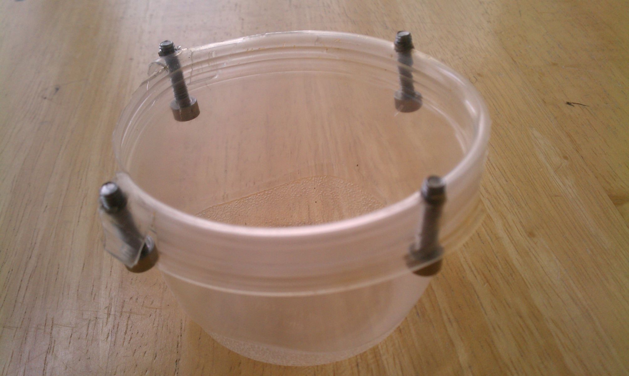

Here is one I made solely for testing the for seat leaking and float levels.
I know you're looking for exact clear replicas of the originals. That would be really cool. I would love to have a set if you find them.
In this video clip you can see it fill up at the 3:45 minute mark.

my best effort yet..
I want a set for the bs 34s so if someone comes up with a link please share

Right! these are the clear bowls I'm talkin about. just cant seem to find any anywhere that fit to my applications, other than dirtbike.
I think thier ok with ethanols, but from my experience new gasses tend to make clear plastics white after a while. I'd be inclined to test that theory though.
I like the homemade fuel bowl setup there. I have done similar in the past for setting fuel heights. Works great.
