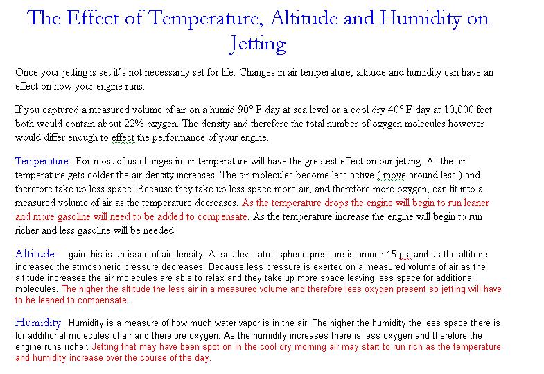

Now keep in mind, huge jump in temperatures, humidity air density etc... she'll run rich or lean pending conditions. Example, you change elevations recently where running, she'll run rich due to thinner air.
Maybe this will help just in case...
