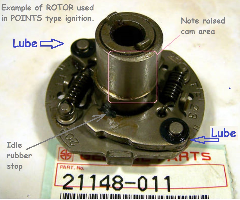

Besides all the other things being checked, would also assure that the timing advancer is functioning properly and not stuck in the closed idle position. May require lube or both cleaning and lube.
Best to observe the advancer as it operates with the engine running under a strobe-type timing light and confirm it quickly moves back and forth as rpm is varied by blipping the throttle.

Patton- Ill have to read into checking the timing advancer. I have never done that before. Ill look into buying a timing light. Ill do this <-- sometime soon.

13 Jul 2011 13:10leopardpepper wrote: ...have to read into checking the timing advancer. I have never done that before. I'll look into buying a timing light....
Would at least put a drop of oil on each pivot point, accessible through the timing inspection window.
This alone might possibly resolve the reported problem.

I would agree with Patton that the advancer movement needs to be inspected, if not cleaned and lubed. It could be that it was binding after a little moisture, but is not freed up from heat and vibration. That is where I would start my troubleshooting.
