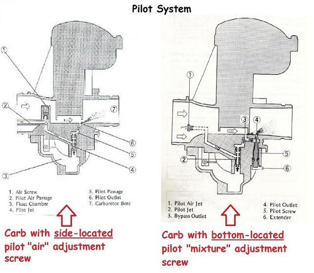

A rule of thumb is that when a pilot adjustment screw is located on the air box side of the carb (such as a side-located pilot air screw), it screws out counter-clockwise to add more air, which provides a leaner pilot circuit mixture.
And when a pilot adjustment screw is located on the engine side of the carb, such as a bottom-located pilot mixture screw, it screws out counter-clockwise to add more mixture, which provides a richer pilot circuit mixture.
Here's a comparison of manual slide carbs:

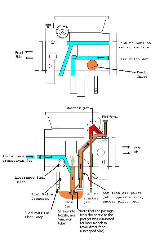

May be wrong, but thinking '75 KZ400 has CV carbs (not manual slide), with top-located pilot mixture screw on engine side of carb, akin to the BS34 carb illustrated below, which would screw out counter-clockwise to add more mixture, and thereby provide a richer pilot mixture:
