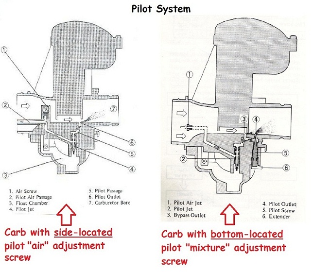

55fbomb wrote: ...have set the floats....
Fuel level is the critical factor, not float height.
Measured "float height" is a stab toward achieving the proper fuel level, but should wind up being whatever is required to attain the correct fuel level.
See clear tube illustration below.
Would remember to turn the pilot air screws out counter-clockwise, which adds more air to the pilot circuit mixture, and should thereby lean the existing apparently over-rich pilot circuit mixture.
Good Fortune! :)

If carbs have bottom-located pilot mixture screws, the screw turns in clockwise to lean the mixture, and turns out counter-clockwise to richen the mixture.

Ok, i put the 17.5 pilots back in and set the mixture screws to 1 turn out and it runs much better now, a little fine tuning and i think its gonna be OK. I did uncover somthing else tho, the mixture screw on the number 2 carb doesnt seem to do anything, i can run all the other ones in the whole way and hear the engine start to sputter, and number 2 i can run in the whole way and it doesnt seem to make any difference. anyone know why this would be? i cant get any of my bowl drain screws out so the clear tube test is gonna be a problem, and i dont wanna risk stripping them out and having my bike down.

55fbomb wrote: ...17.5 pilots back in and set the mixture screws to 1 turn out and it runs much better now...the mixture screw on the number 2 carb doesn't seem to do anything, i can run all the other ones in the whole way and hear the engine start to sputter, and number 2 i can run in the whole way and it doesn't seem to make any difference. anyone know why this would be? i cant get any of my bowl drain screws out so the clear tube test is gonna be a problem, and i don't wanna risk stripping them out and having my bike down.
If turning the pilot adjustment screw fails to influence rpm, would suspect an imperfect pilot circuit for whatever reason, despite the reported cleaning, oftentimes due to an obstructed passage (see earlier posted diagrams of pilot circuit), or perhaps due to a damaged pilot screw (perhaps the pointed tip is damaged or its seat - orifice - is damaged), or using an incorrect pilot screw.
Where carbs are in fact clean and in otherwise perfect condition, an excessively rich pilot circuit may result from a too high fuel level (as earlier noted).
:unsure: Has water mist been sprayed onto #2 exhaust pipe while engine is running at idle rpm to determine whether #2 cylinder has combustion?
Mist is supposed to instantly vaporize (i.e., sizzle off).
With float bowl removed, may help to remove the drain screw by allowing to soak in PBBlaster or mixture of 50-50 acetone and ATF.
And could also try applying heat to the bowl area around the drain screw.
Are the drain screw heads in good condition? Or have they been damaged during efforts to remove them?
It's essential to use a screw driver having a tip that perfectly fits the slot in the head of the drain screw.
Have in the past resorted to using a hand held impact driver, but must be careful so as not to over-do it ala Godzilla.
Likely could be especially important to check and assure correct fuel level in the #2 carb.
Good Fortune! :)
