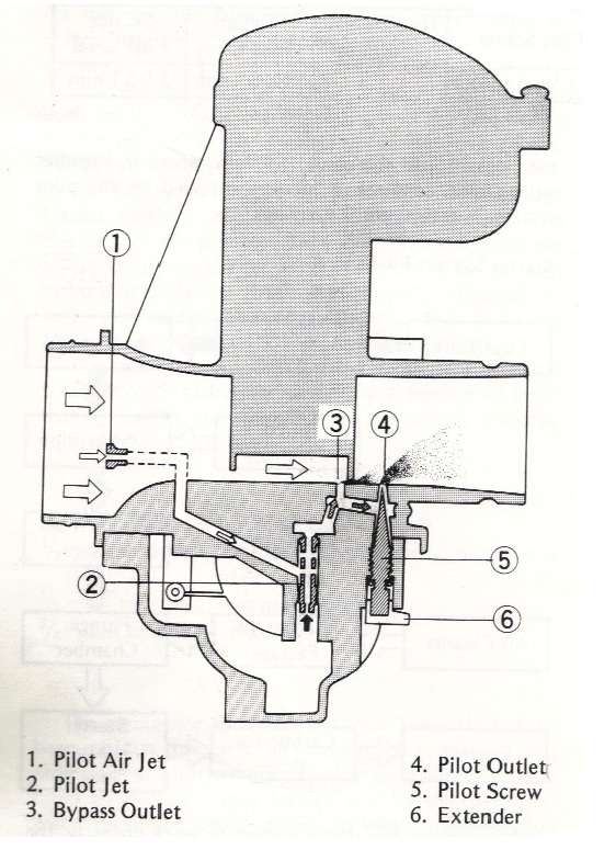

If not already done, would also assure that the timing advancer is functioning properly. By watching it under a strobe-type timing light and seeing it quickly move back and forth as rpm is varied by blipping the throttle. The advancer may require lubing, or both cleaning and lubing.
Meanwhile, Boo on me for suggesting that the carb pilot circuits are still imperfect regardless of the reported cleaning.
Oem carb pilot circuit looks like this:
May adapt the following pilot circuit cleaning method (illustrated with side-located pilot screw) to use on carb with bottom-located pilot mixture screw:
Wear eye protection!
