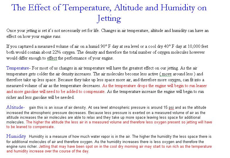

Re: Rejetting for Temp. and Humidity
05 Jun 2011 10:50

Generally speaking I was schooled that a ambient change of temps from 10 to 15F would ideally require a one size jet change. However on a street driven motorcycle in New England, I would find myself changing jets every day... lol
This suggestion is from a pure "top racing tune" type application
I try to jet for top performance around 65F, and whatever happens there after for temps is a compramise. So my bikes run slightly rich at 80F, and slightly lean at 45F...

Thanks Guys,
That's what I figured was going on. I guess I'll have to order some more jets, and lean it up a bit.
Thanks for the info.
