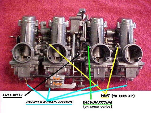

does anyone have any info on the 28mm mikuni slide carbs. I am using a set of these on a 78 Z1000 engine they have an accelerater pump fitted and there are two hose connectors coming from the float bowl where the pump is situated i know that one of them is the fuel overflow but unsure what the other is for can anyone help me out here

08 May 2011 15:56 - 08 May 2011 16:01Note fuel pump on #2 carb.
#2 fuel pump connects via lateral hose to #1 carb.
#2 fuel pump connects via another lateral hose to #3 carb.
#3 carb connects via a third lateral hose to #4 carb.
All four carbs are thereby served by the single fuel pump.
