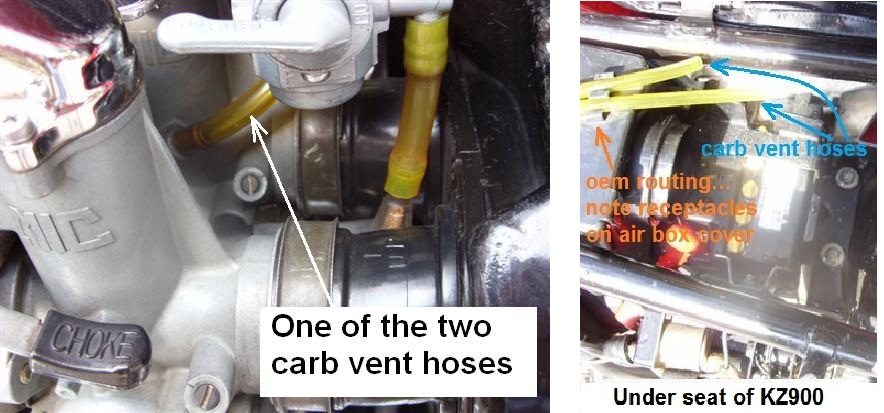

wdizard wrote: Do the floatbowl vents connect to anything?
Greg:)
Oem routing of hoses from the two float bowl vents is through the frame to exit underneath the seat.
Note hose grips molded into top of air box for this purpose.
Good Fortune! :)

The hoses attached to the overflow nipples on bottoms of float bowls are usually routed to exit underneath the bike.
Here's a pic of the oem hoses showing how they are routed.
Good Fortune! :)
