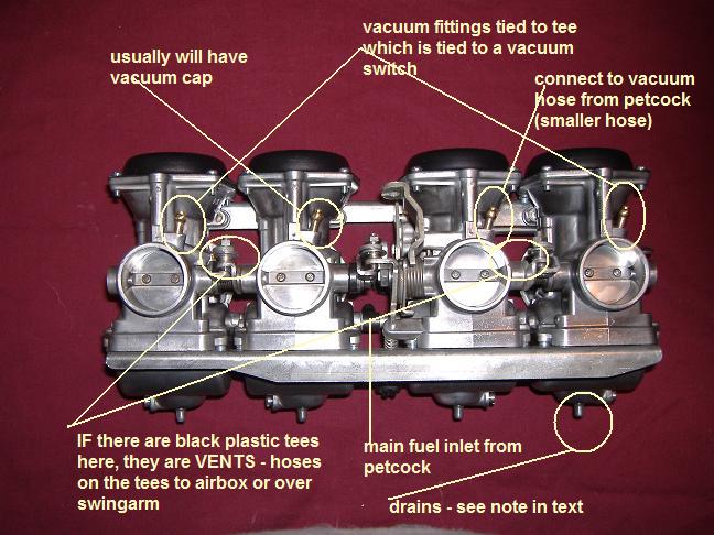

Re: vacuum lines
24 Apr 2011 18:25
thanks for the pic it has one tube from the vent tube on the second carb and one from the middle carb and the fuel line going in on the middle as it's a canadian bike it doesn't have the air suction system as the us models so i'll put one line to the petcock and just cap off the other one and try that thanks

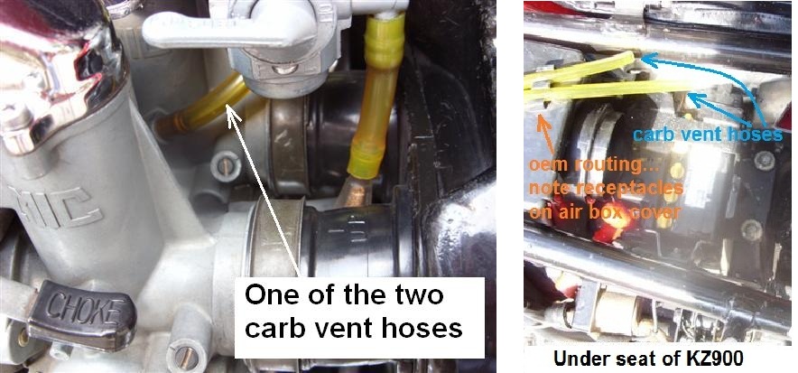

13 Jun 2011 02:50Archiddeon wrote: ...question regarding the air suction system...'83 GPz550...no airbox, instead having 4 separate air filters, one on each carb. The two vacuum lines from the top of the cam cover have been connected to each other, is this ok? What effect will it have? There are T's between carbs 1 and 2 and between 3 and 4. These are connected to two separate lines that were dangling down beside the engine. Are these the vent lines? Should they stay unconnected, but nicely routed? What are they vent lines for? The vacuum for the petcock comes off carb 3, the others have what appear to be factory seals over the connectors....
The two vacuum lines from the top of the cam cover have been connected to each other, is this ok? Yes.
What effect will it have? None.
There are T's between carbs 1 and 2 and between 3 and 4. These are connected to two separate lines that were dangling down beside the engine. Are these the vent lines? Yes.
Should they stay unconnected, but nicely routed? Yes.
What are they vent lines for? Float bowls.
Vent hoses should exit to open air. Some folks route the hoses over the swing arm (along with the overflow hoses) to exit underneath the bike. Others retain the stock routing to exit underneath the seat, such as shown below on KZ900.

The engine looks mostly stock (except that the airbox is gone with each carb having it's own air filter and the lines from the tops of the cam cover being connected together), including the petcock (took it apart to clean and definitely has the vacuum seal in it).
But ... the vacuum line to the petcock is coming off the carb for the 3rd cylinder (sitting on the bike, it's 3rd from the left). It doesn't look like it's been tampered with as all three of the other carbs have very neat black plastic caps covering the vac connection. Any ideas why the change here?
The first photo is a top-down iew of all 4 carbs. As you can see, fuel enters between 2 and 3, but vac line comes off 3. The second pic is an engled shot looking in at carbs 2 and 3. See the black cap on carb 2?

13 Jun 2011 12:46
It doesn't matter which vacuum nipple is used to supply vacuum through a tube to the petcock, as any of the vacuum nipples may be dedicated to such purpose.
Some 4-carb sets are designed with a 5th vacuum nipple for the petcock. But even then, any vacuum nipple may be selected.
Any unused vacuum nipple should be capped (plugged).
