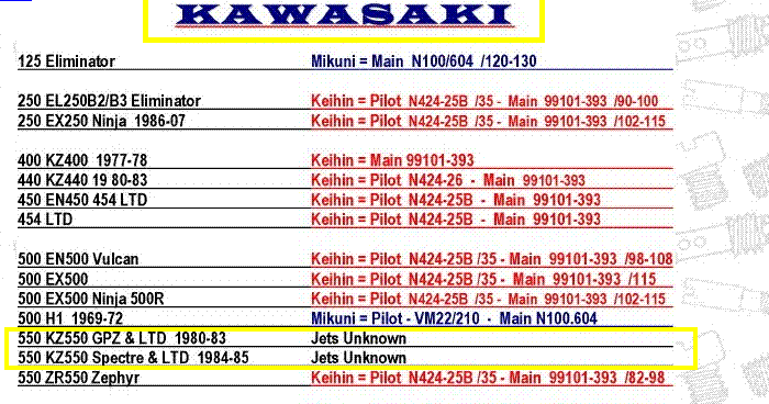

Z1 does not carry TK-22 jets that I know of.
pjmotorsports doesn't either.
In fact, I have never seen any source for the jets other than the TK-22 carb rebuild kits and the Dynojet kit. I get the rebuild kits then drill my own mains and pilot jets.
The TK-22 carbs use these kits:
K&L rebuild kit 18-2462
Keyster rebuild kit KK-0049
Or you can try the Dynojet 2305 kit, but that only has mains (and new needles).
The TK-22 can also use small-head Keihin main jets.
I have never seen a pilot jet that was a direct replacement. but you could try a bunch of pilot jets and see if any fit. For me, it's just easier, faster, simpler to just drill them. Many people will tell you it won't work and that getting new ones are the only way, but so far no one has supplied a link to where to get them.
Here's the pjmotorsport fitment page,

www.pjmotorsports.com --> "Jets unknown" for KZ550.
