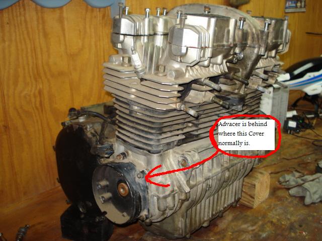

Pardon my noobness but where is this advancer unit located? Is it the thing that has the throttle cable linkage that operates the carbs in unison? If not then where...

Click For Advancer Area---> First Pic
