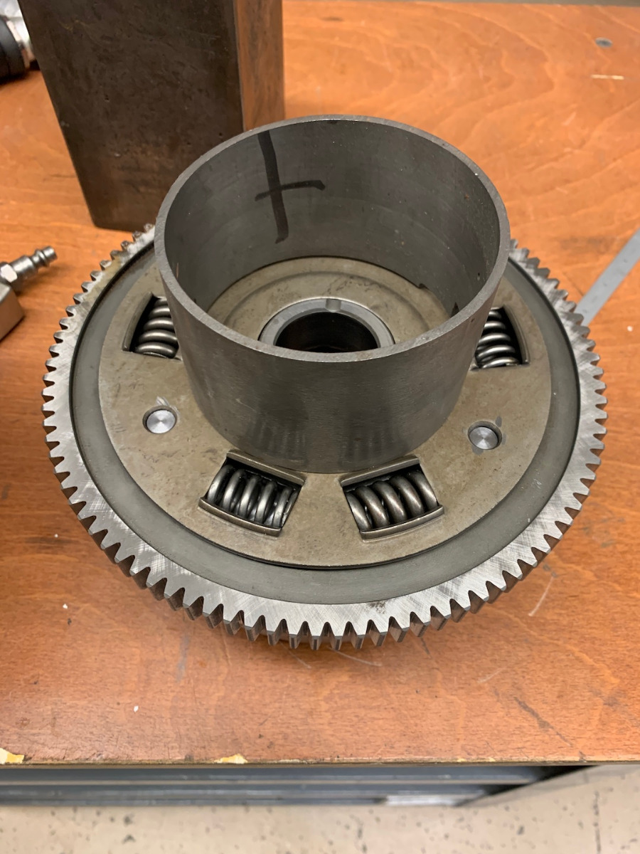

If the rivets appear to be welded it's probably because the the springs have been replaced before. I just replaced them in my kz1000 and it's not difficult. The trick is to be sure that the inner and outer spring retainer disks are compressed tightly as the bellville washer will be under tension. I was able to do this with two pieces of tubing. One against the rivet heads inside the basket and the other against the outer spring retaining disk. It was compressed in the hydraulic press and then welded. It could be done with three c-clamps as well.

Thanks All for the responses and answers. Got my fixture all made up to compress everything together for welding, might do it tonight ill post up some pics when i do.

I did this on the cheap, by filling the worn spots in the spring retainer disk with silver braze and stretched the springs with a wedge. The rivets were made out of 8620 bar stock, a bit oversize so every thing went together nice and tight.
It's all straight forward except compressing the parts together before welding the rivets.
