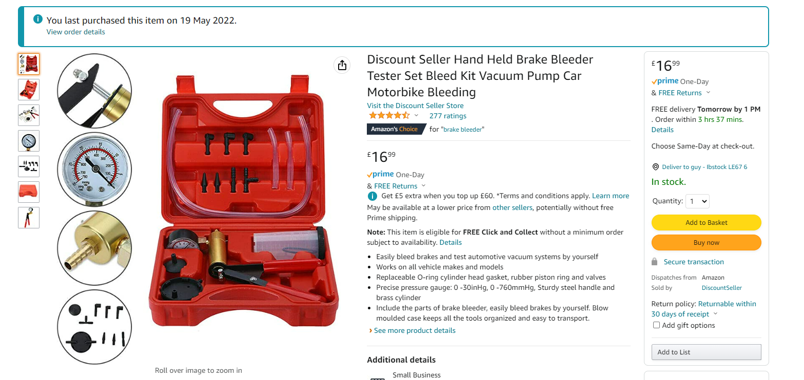

23 Jun 2022 14:47 - 23 Jun 2022 14:50I have recently bought this one (haven't used it for bleeding yet as I bought it to test the "active" engine mounts on my car) it holds a vacum no problem with a couple of pumps. With vacum bleeding the seal is less critical as you are sucking from the nipple (so to speak) so you won't introduce air to the system REMEMBER TO CLOSE THE NIPPLE BEFORE YOU RELEASE THE VACUMCould you recommend a good one? My bike has the remote reservoir, an 82 GPZ750 and Im in Montana US
