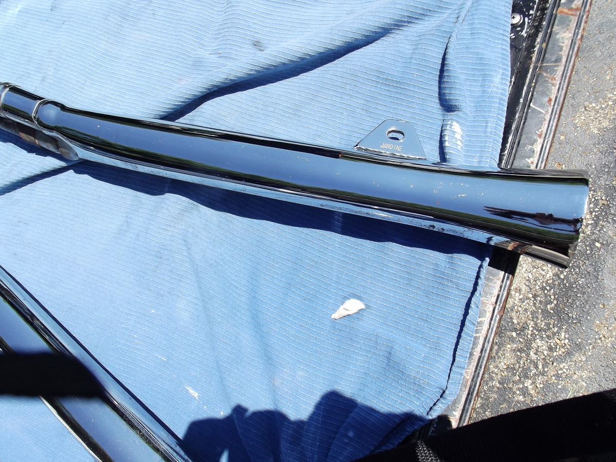

Thought ltds had jardine exhausts?

08 Mar 2016 09:54They did, these are the ones from my 80 LTDfloivanus wrote: Thought ltds had jardine exhausts?
Pete
