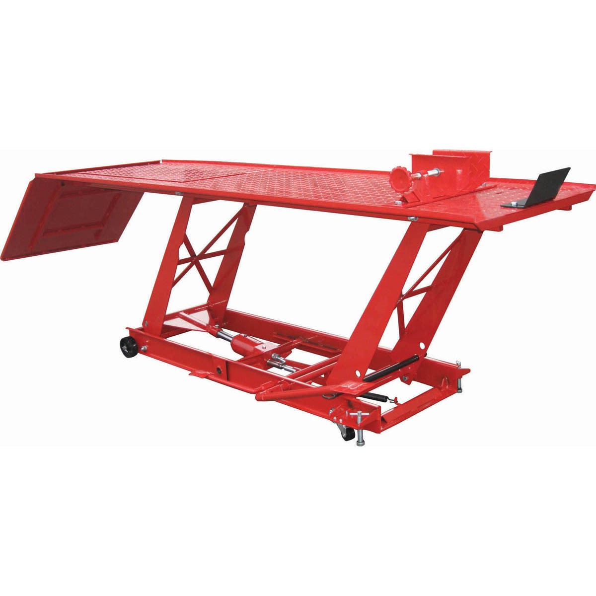

This is what I use but I got it from my neighbor used for $150

18 Jul 2014 11:41 #640508 by kaw-a-holic
Replied by kaw-a-holic on topic What lift do you like best for your KZ1000?
:whistle: that is slick! I have seen some guys use the frame lift and make spacers the keep it from lifting the on the oil pan. I like the table lift.

18 Jul 2014 12:59 #640515 by jakedude
Replied by jakedude on topic What lift do you like best for your KZ1000?
The lift show by kaw-a-holic looks just like my harbor freight unit. I bought mine last year and paid $150 with a coupon I got on-line at their web site.
I added a few more tie downs. I have had my kz1000, dl650, and my gl1500 up on it. My only complaint is that when you ride the bike up onto the lift, if you center the bike on the lift, the bike side stand hangs over the edge of the lift. For my kz1000 and dl650 thats not such a big deal. I just leave a little more room on the left side so I can put the side stand down. Then I can get off the bike and put the bike on the center stand. For my gl1500 you need to have the bike centered because the bike weighs 900 lbs which is right a the limit of the lift (1000lbs). If the gl1500 is not centered, when you lift the bike the stand leans which is not safe. I plan on adding a small metal plate extension on the left side so I can put the side stand down.
