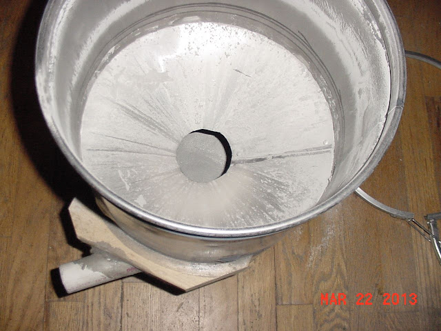

Speaking of that... RStar45 I would like more info on how you built your accumulator.

Sure Jim,
Block of wood to help glue / hold an input directed at the side of the bucket sets the air spinning.
Made a cone to fit just above the inlet.
And a couple air filters on the lid.
Sure glad you asked... I really need to clean that sucker. :lol:
