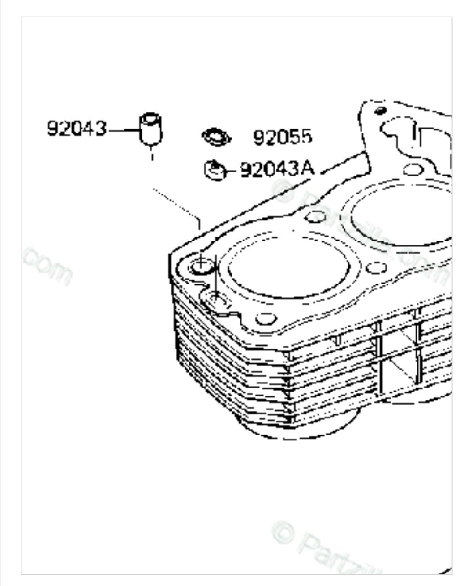

I'm back on this issue and hope to fix this fall or at least over the winter. After riding the bike myself a couple weeks ago and more closely examining for leaks, I believe the leaks are coming from the upper engine. I removed the generator and ignition covers and there is no oil anywhere inside. None of the four half moons have any oil on or near them so I don't believe they're leaking. Also, I see no oil on the gasket for the cam shaft cover. The head gasket and cylinder gaskets are wet in spots so I believe they are the issue. See attached photos.1st pic is left side overall, 2nd head gasket, 3rd cylinder gasket and 4th show dry half moons. Does my assessment appear to be correct?
This will be a big job since the whole upper has to come apart. I have not had a motorcycle engine apart so a bit nervous to go ahead, but I think I can do it with advise, the manual and being careful as long as I can acquire a complete upper engine gasket/0-ring etc. kit. I believe i should replace all gaskets and seals. Yes?
1) Is there anyone in the Minneapolis/St Paul area who has worked on any KZ?
2) Where can I buy a gasket kit?
3) Any tips or tricks and cautions? I know the cam chain has to be held up with a wire so it doesn't drop in the engine.
4) Any special tools required besides a torque wrench?
Appreciate very much advise and help. This bike is in great shape as you can see and I really want it repaired so it can be ridden a little each year. One of my other sons is interested in learning to ride and this is a great starter bike. Another son who rode this in June and July when the leaks started is now riding and bought Harley Road Glide. Thx much!

It's possible that the oring is leaking in between the head and the cylinder. Taking the head off isn't that hard if you know what you're doing, just follow the manual. The main issue is getting the camshafts back in time. You'll probably need a valve cover gasket, cylinder head gasket, and the two orings. When the head is off is a good time for a valve job!

If you remove the head you will also need a base gasket, once the pressure is released it's unlikely to seal

OEM gaskets are superior to aftermarket "gasket kits". You may want to dig out the PN's needed then search places like eBay, Partzilla, or your favorite dealership source. Only buy aftermarket if OEM is unobtainable
