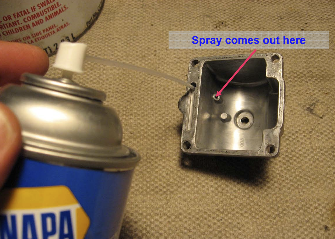

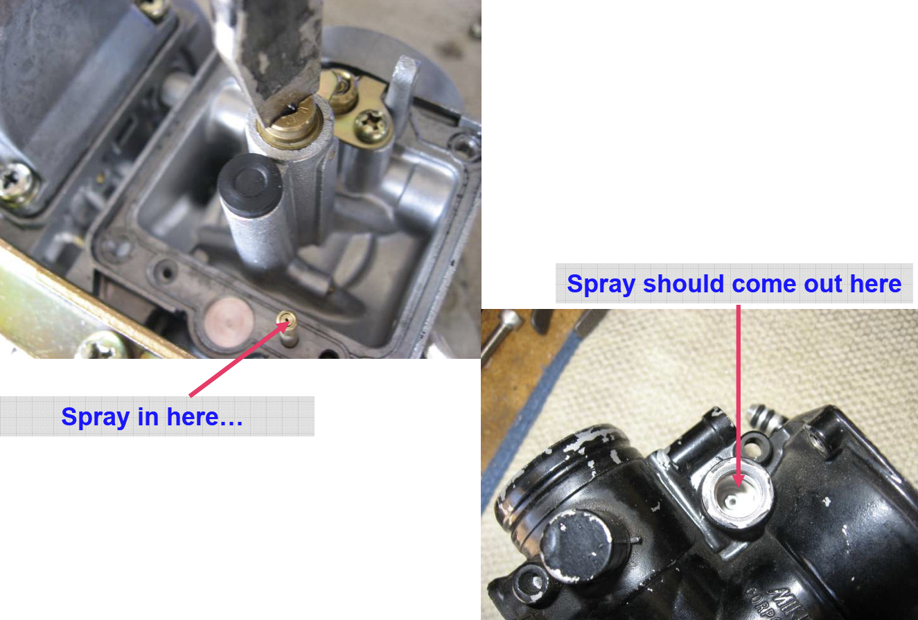

When you rebuilt the carbs, did you verify the choke passages were open?

Yes I completely took the carbs out this winter, replaced all the rubber and brass parts. Cleaned it all in ultrasonic cleaner.
