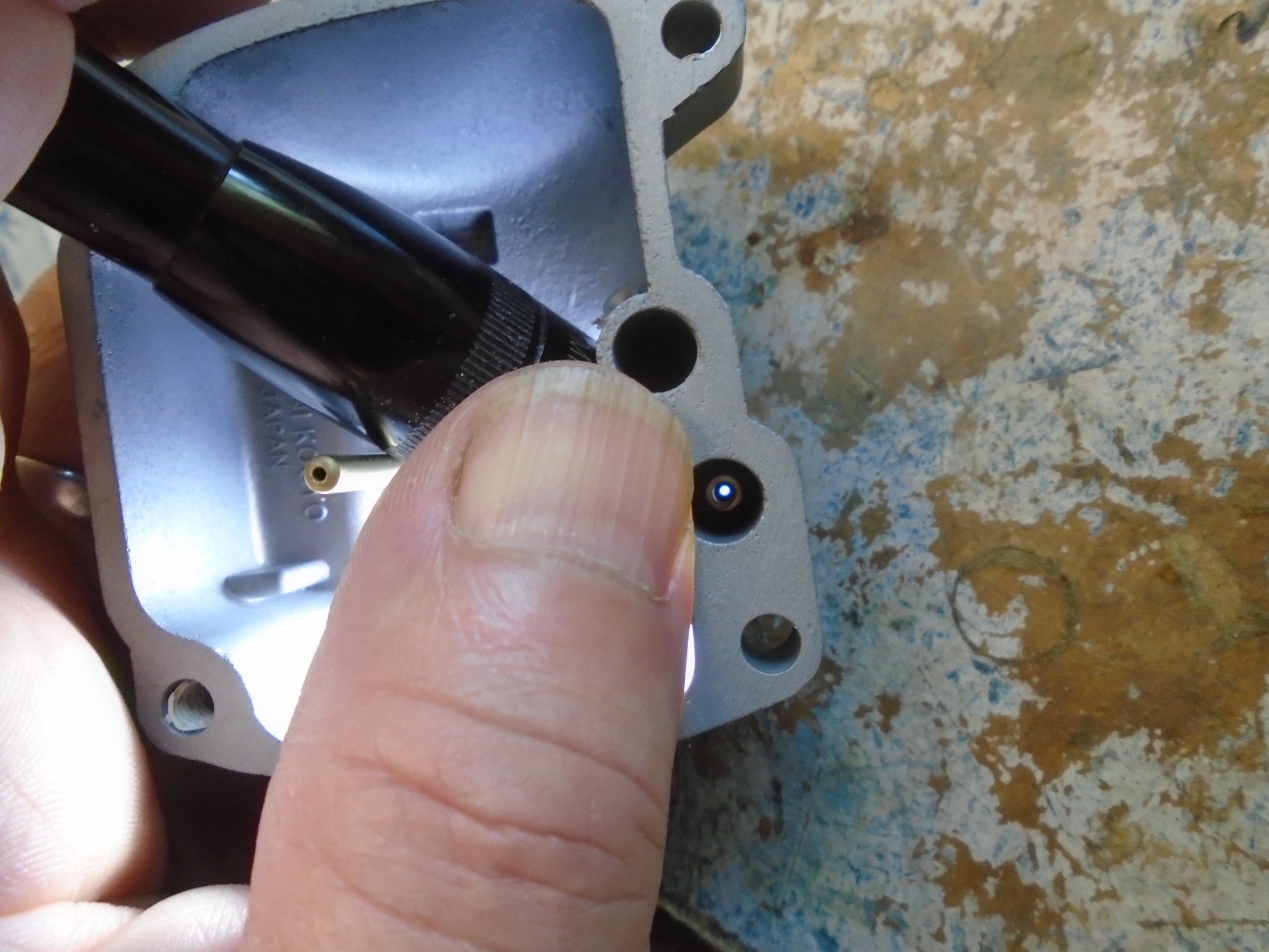

Before You find Yourself stranded and Nerdy has to loft your little bike to a safe depot, check some stuff ya might of missed. That tiny bypass hole circled in marker, has to be clear, essential!! Should be able to shine a light thru the pilot jet hole and clearly see a ROUND hole. Gotta emphasize Magnifying glass!! Without it all you will see is a glimmer of light, Really focus the glass on it!! I have containers of this stuff, isn't above Your pay-grade, just look better. You cats have fun up there!!!
