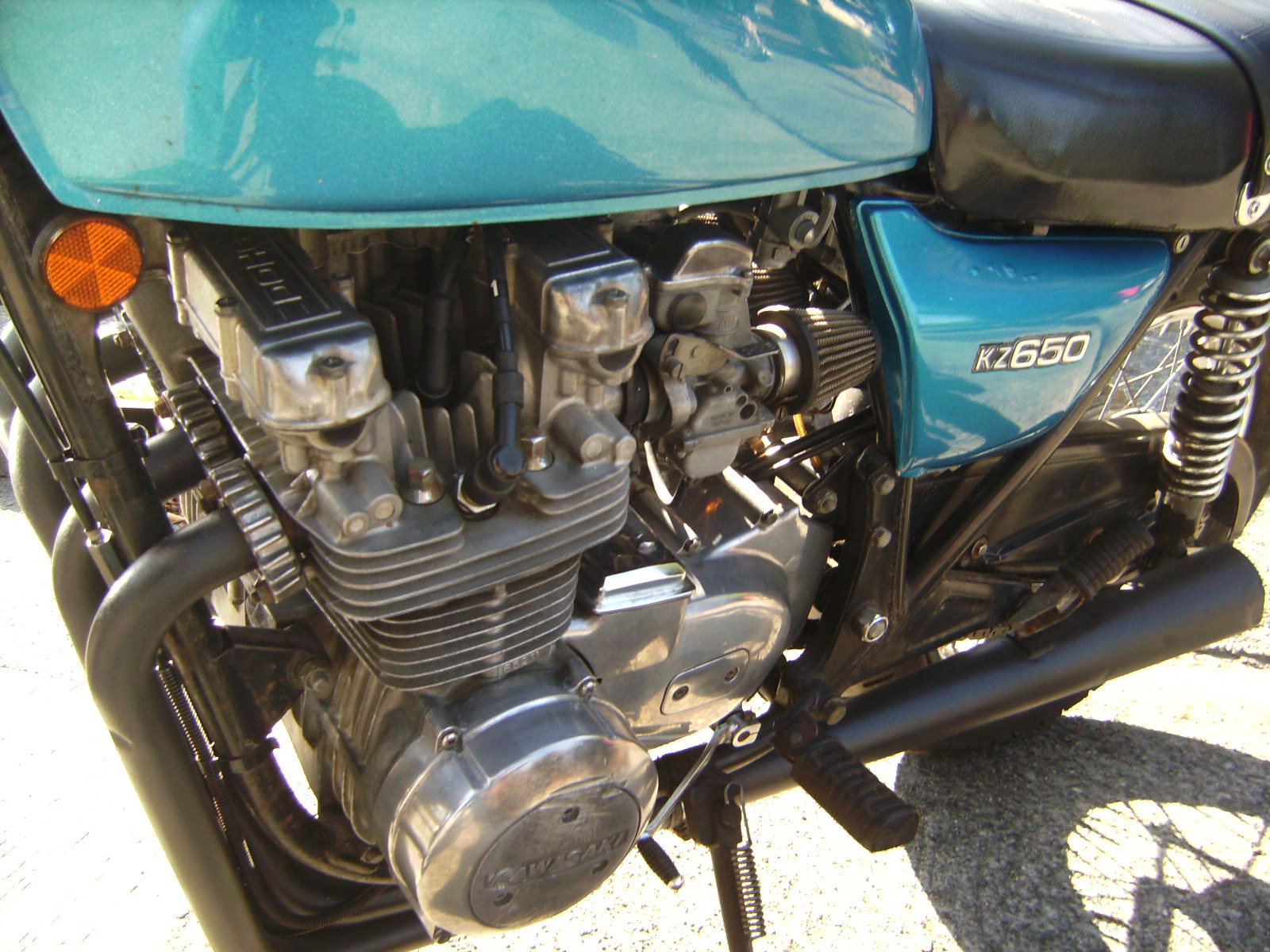

I've decided to replace the cable. Further inspection revealed that the cable has rested on/gotten too close to the header and melted the outer covering near the middle tension adjuster. If the inside of the cable was coated before, it's not now.
Can i get some pictures from folks on how their cables are routed? Side question, why does everyone only photograph the right side of the bike, and never the left???

Not sure how much these will help or not but here you go. These are the current pics I have that do show the cable route on my KZ650.

Re: very stiff clutch lever pull
25 Sep 2024 10:20
That helps a lot!
Thank you!
I see the clip mentioned in other replies. The clip on mine looks pretty rough compared to yours. I also see that there's a "spring" wrap around the lower half of the cable.
It looks like the cable is held "outside" the frame until the bend at the bottom, then runs "inside" the frame back to the sprocket cover.
Is this how everyone else's cable is routed? My bike has a 4-1 header on it, that swings over to the right side of the bike. Meaning it passes over this cable a little below the middle tensioner bit.
Thank you!
