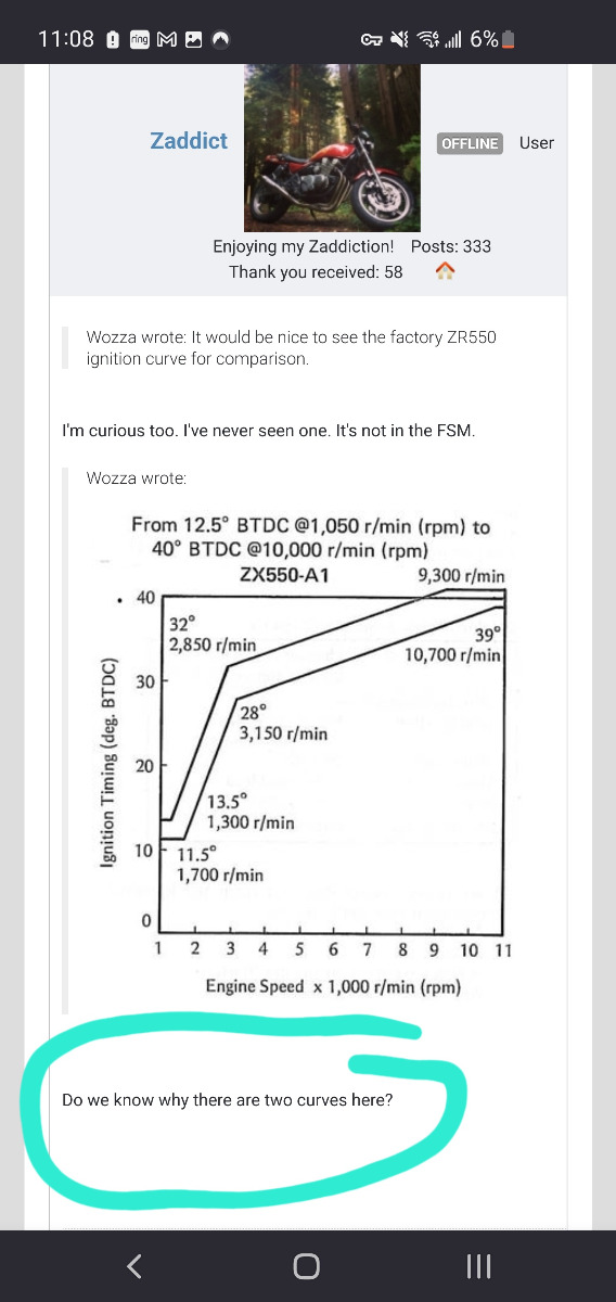

Can anybody tell me why there are two different curves in a timing advance graph in the manual? I can’t seem to find any answers to this in the forums. My apologies in advance if it’s already been explained somewhere. Any information is greatly appreciated.

That chart doesn't really show two different curves.
It shows timing advance in relation to engine speed.
The right hand line is full advance approaching 2000 rpm and above.

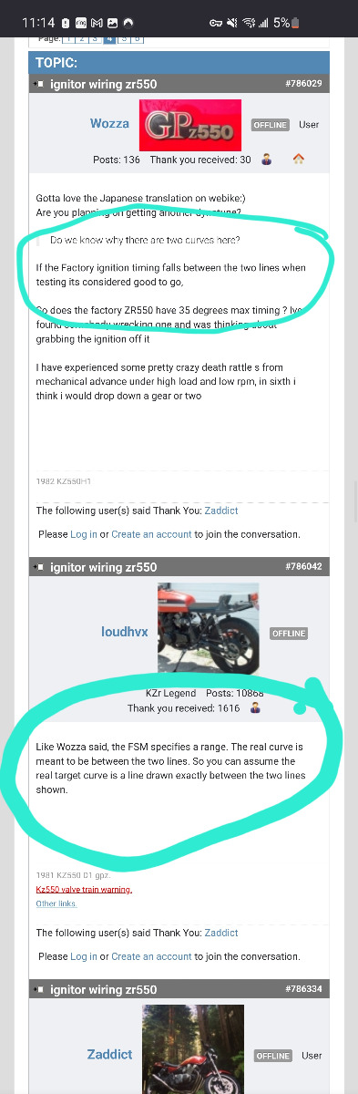

Agreed, the area between the lines should be "shaded" for clarity. E.G.: the graph for my "K" shows an upper reading of 41.5 and a lower reading of 38.5 at full advance (factory spec is 40) this is in part due to manufacturing tolerances of all the components involved (bob weights, spring tension etc) All "mass produced" components have a "tolerance"
This is in part why modern engines of smaller capacity make more power, where ignition curves and fuelling can be "mapped" to get the best out of the motor.

Those curves are from a 1984 GPz 1100. It does not have a mechanical advancer. The advance is electronic within the igniter.

There will still be manufacturing differences between the components involved (trigger, pick up coils etc) the area between the two lines represents "in spec"

the tolerance in timing error doesn’t come from the electronic ignition. It comes from the accuracy of drilling the dowel pin that determines TDC in the end of the crank. The crank end diameter is so small that even a couple thousandths difference can equate to a few degrees of timing error. I personally have found 1-2 degrees timing error on different cranks from the era. Nothing to do with the ignition system at all.
