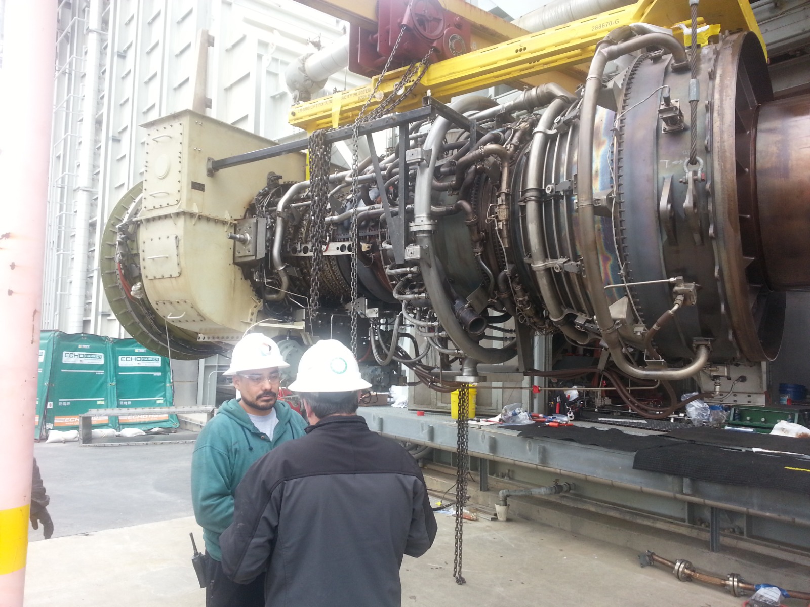

I work in a power plant. I have tried to tell many folks it's like a giant car. It has a starter, it has a lube oil system, it has a cooling system. Hell... it even has a generator!
The point I'm trying to make is this... when we do a "start up", we look at ALL the "systems". First we need a solid connection to electricity. 15KV breaker serving the plant... check.
The hydraulic system needs to work, for the starter to work.
The cooling system & lubrication systems need to be up to snuff in this weather or we're stuffed...
Ad infinitum until you've covered everything involved.
The need to look at the bike system by system is vital for a successful start up! As they say... "YMMV"!
