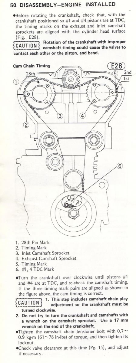

The pic you have posted does not relate to the 78 z1000 engine with roller camchain.
It relates to the later J type with hyvo "silent " type camchain and those timing marks cannot be used with the earlier engine.
The attached pic is what you should be using as reference.

Hello,
the picture i post is for valve shims clearance check.
The picture you send me is to set the timing. I did it like that.

05 Jun 2022 11:54Your first pic is for the later engine so does not apply for either cam timing or shim checks.Hello,
The cam sprockets and markings are totally different.
You should be using the relevent manual for the engine type and model.
Regardless of engine type you just need to make sure the cam is fully on the base circle to perform clearance checks.
To be 100% certain of this then make sure the cam lobe is facing directly away from the shim.

When i put the exhaust camshaft sprocket in place at the T mark the arrow and the 0 pin can't be perfectly aligned with the cylinder head surface (like in the example). But a little more up.
Between the 0 and the 1st pin in fact... Normal ?
To have the exhaust camshaft sprocket in place at the T mark the arrow and the 0 pin aligned with the cylinder head surface i must pass the T mark a little bit...

05 Jun 2022 12:53 - 05 Jun 2022 13:01Yes! Normal."To be 100% certain of this then make sure the cam lobe is facing directly away from the shim. "
Yes i did this method too. But with shims at specs i always have this 'click click' sound.
When i put the exhaust camshaft sprocket in place at the T mark this one can't be aligned with the cylinder head surface. But a little more up.
Very rarely does the pin line up exactly with the surface.
This is due to camchain wear or deck height tolerances, gasket thicknesses etc.
When doing the cam timing always use which ever pin is closest to the head surface and count that as zero regardless of whether it is slightly above or below.
If the head surface is exactly between two pins then use the pin below the surface as chain wear etc will gradually bring that pin closer to the gasket face.
Last edit: 05 Jun 2022 13:01 by zed1015.
