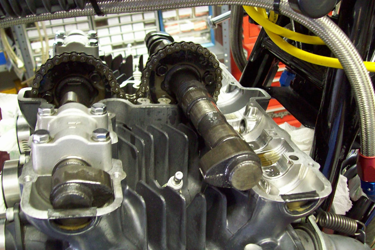

No problem using the shim over buckets from a 900/1000.
You need to use the matching 900/1000 spring retainers as well as i'm sure you already know.
The limitation. just like the 900/1000 is the lift of the cam used so around 410 lift is the max although some cam manufacturers have state 418 before going to shim under.
The main reason for shim spitting is the groove around the top inside lip of the bucket.
When the cam lift is so high that it sweeps right to the edge of the shim it tips the shim into the groove which can eventually flip them out like tiddlywinks.
Back in the day tuners would fill the groove with silver solder etc to prevent this and some companies like RC Engineering produced lightened aftermarket buckets without the groove for racing... See attached pic...

I needed to replace only one intake valve shim. I locked the chain to the sprockets with zip ties (and put paint marks just in case), & locked the cam chain tensioner. I unbolted the cam and moved it up and forward out of the way and kept everything taut with a bungee up around the frame....swapped out the shim and everything went right back into place. I imagine you could then do the exhaust cam the same way. It wasn't bad really
