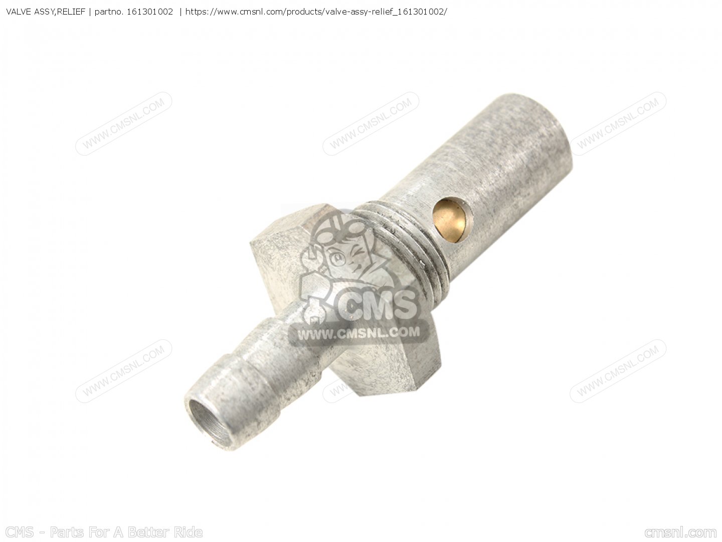

Have to ask, is this the check valve you are talking about???
The check vale tend to be clogged with rust and then get stuck = not fuel will flow back into the fuel tank.
It can be disassemble with a drift punch if needed. Take pics tomorrow....

that's exactly it. the bike wasn't running right when I got it together last month. the fuel pressure was too high (50 psi). when I took it apart and drained the tank the tank was full of varnish so, I cleaned it out and coated it. I am just curious if I need a dressing on the new gasket or if treat it like a paper washer and tighten it down. any advice is appreciated.
