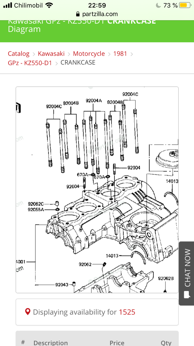

Have you checkef partzilla.com ?
I took a quick search, looks to be part number 92004?
www.partzilla.com/catalog/kawasaki/motor...z-kz550-d1/crankcase

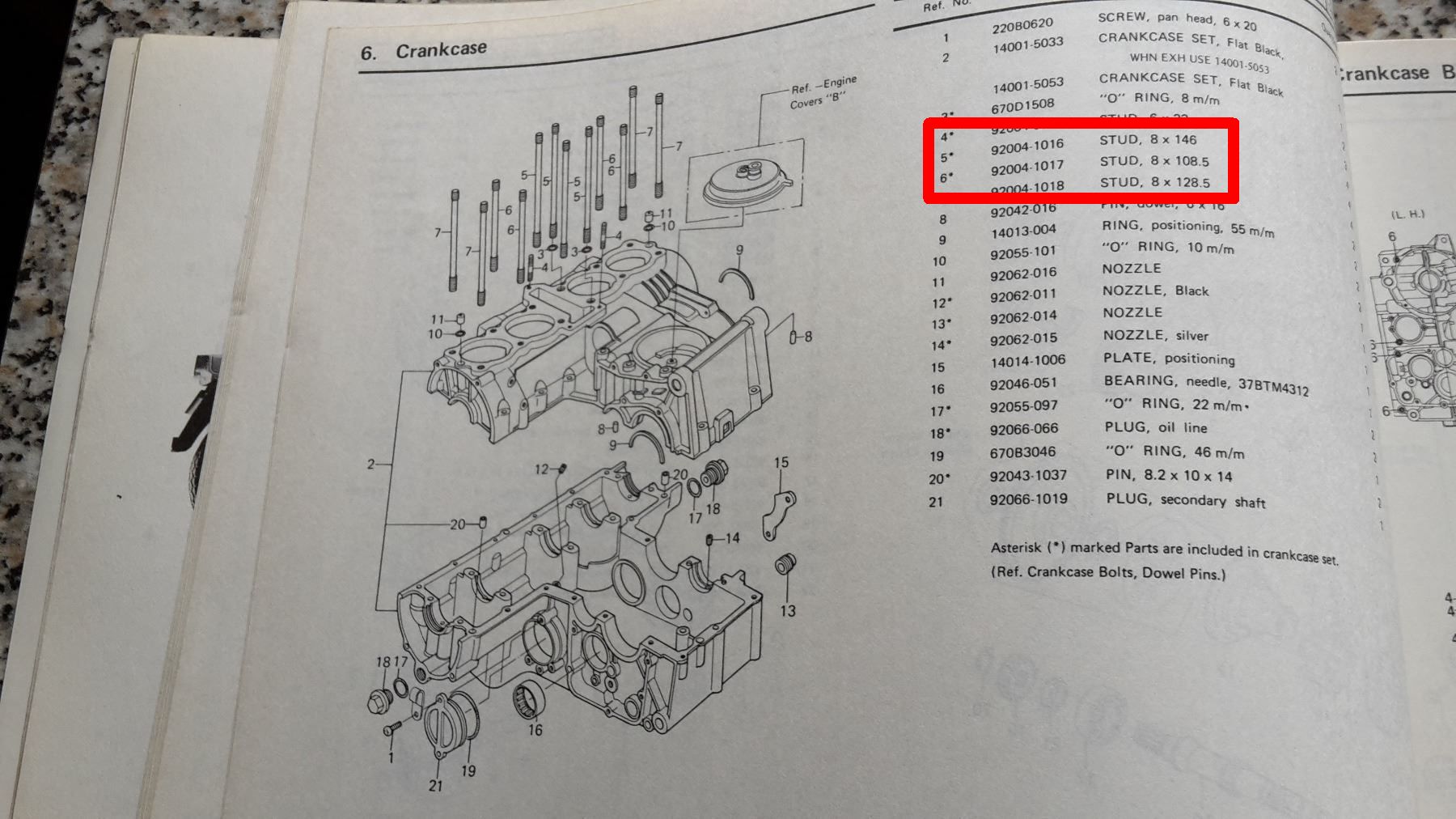

Z500 was for European market and as far as I know there is no online parts list for it. However some paper versions of parts lists could be found in Europe. Like this one:
www.ricardo.ch/de/a/kawasaki-z-500-ersat....katalog-1067396840/
According to sample images from that book Z500 has cylinder studs identical to Z550.

His over all messurments of the studs are +20 mm longer (OEM110/130/145 mm) against his messurments 130/150/165 of the studs.
- gazzz
- Posts: 563
- Thanks: 318
Re: Z500-B3 cylinder head studs
10 Mar 2020 15:41 - 10 Mar 2020 15:42His over all messurments of the studs are +20 mm longer (OEM110/130/145 mm) against his messurments 130/150/165 of the studs.
We know nothing about studs that actually installed in that engine, however Kawasaki Z500 part list says that 500 studs are similar to 550. And I honestly I see no reasons for using longer studs in engine with capacity decreased for only 50ccm. I may only suggest to remeasure studs.
