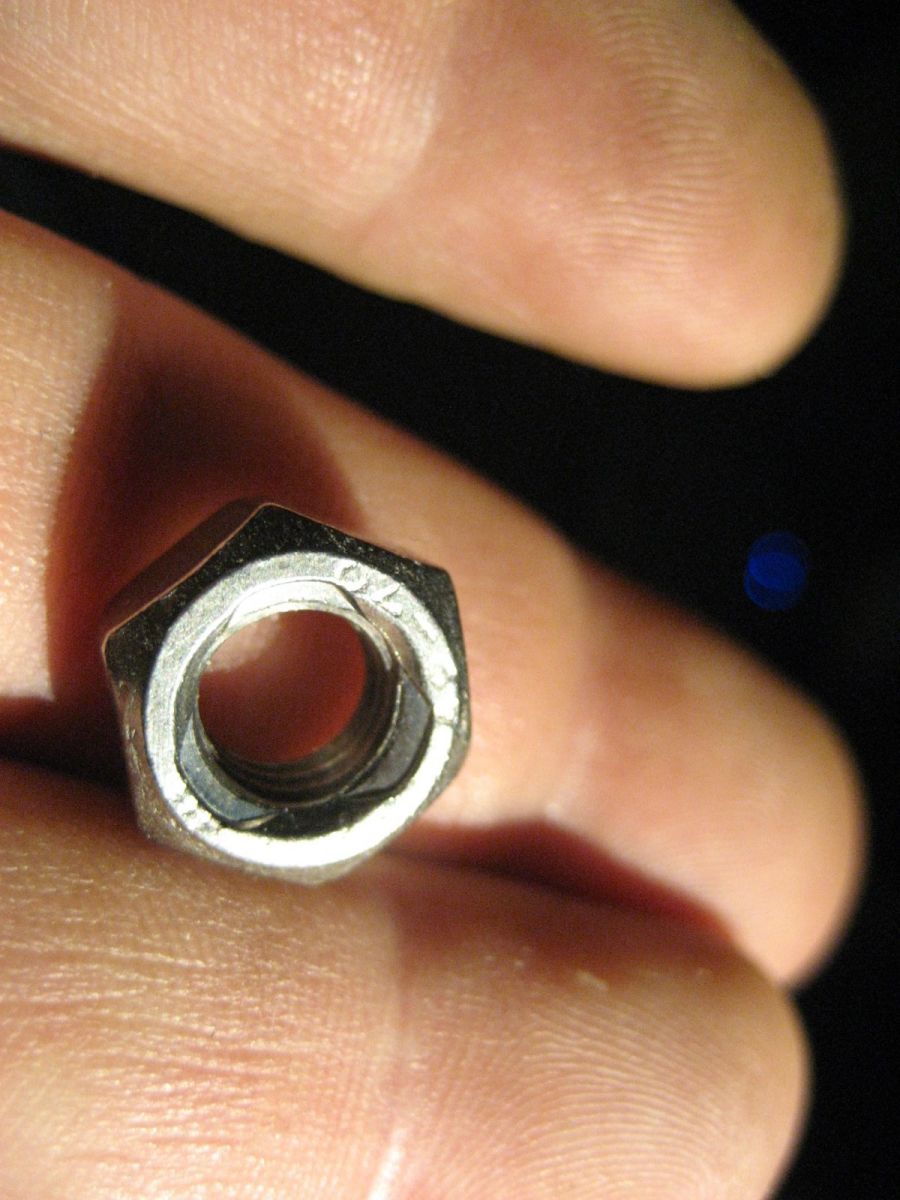

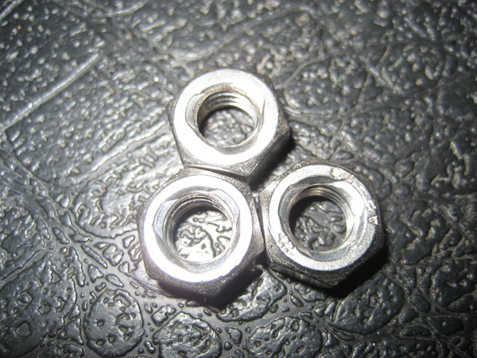

gordone i use stainless steel self lock nuts on my on my exhaust. no nut never ever come loose or need to be re-tighten.
If you want i could send you a set of 20 nuts for the shipping price of 5 Euro. Do you need M6 or M8?
