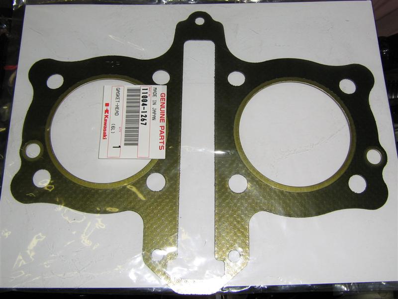

What gasket are you using? all gaskets are not created equal. Kawasaki recalled their early head gaskets for these bikes. Here is some info passed on from a member here
Scirocco wrote: Just some recommendation DoctoRot for your engine rebuild.
Only buy the head gasket part #: 11004-1267, the green one
It´s the last and best cylinder head gasket for the 750 twins
A little gasket history :
11004-071 => 11004-078 => 11004-1055 => 11004-1267
11004-071, recall campaign in June 1976
11004-078, the red one with black middle section
11004-1055, light brown, comes with the first LTD model
11004-1267, the green and the best for the last LTD model
Full story and source but only in German language.
www.z750twin.de/zylinderkopfdichtung.htm

Ok guys. I got the head gasket (the exact one shown in the picture. Greenish tint) and put it on successfully. Torqued the bolts to spec, and followed service manual for camshafts.
