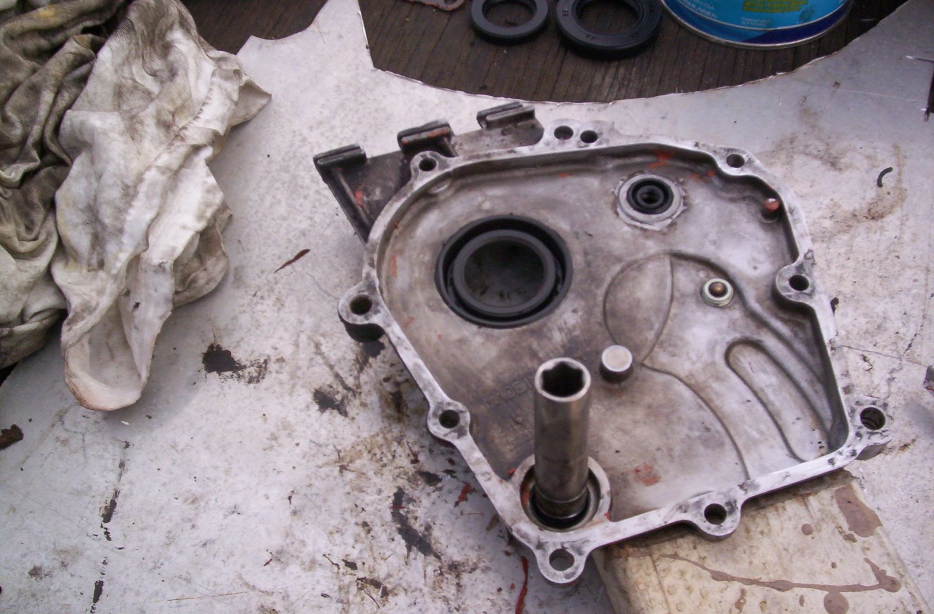

Does the push rod surface have any scratches or scoring marks?
Or do you have maybe put the seal with the inside out.
Some pics would help.

The gearchange lever is clean,it’s got some movement when the outer case is off but seems fine when it’s on and as I said it’s fine for a couple of days then gets bad pretty fast. I can’t do a pic at the moment as it’s a girls from the club that I look after for her. Next time she’s round I’ll post one.
I put the seal in with the metal shield outside,so It drives in evenly with a piece of conduit tube,if that makes sense(and iirc)
I was wondering if it might help to put some heatshrink on the shaft?
I put it in the same way as the pic.

You say you are fitting as per your picture. The picture shows the outside face. You are definitely fitting the seal the correct way round?
