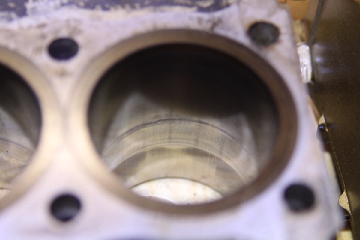

I have open up my engine, and consider the cylinders to be honed or not...
I have not find deep scratch, but I have not a trained eye for it...
When I first have the engine open, will I do everything properly.
I have uploaded photo:
temp.dynamitt.net/div/MC/cylinder/
If I can take photos another way please let me know.
Thank you all for input and support during my rebuild of the bike.

I would combine the two threads. It looks like moisture got into the cylinders judging by the staining. You could try a hone but chances are those bores will have to be bored. Try uploading pics using the attachment and add file buttons. The different color on the valves suggest the amount of oil getting past the rings.

Those cylinders look corrosion pitted where the rings parked on the cylinder wall. Most likely will need a bore job.

I have taken picture with high resolution, so hard to upload there where you have 5mb max...
Cylinders:
Valve:
temp.dynamitt.net/div/MC/valve/
Piston:
temp.dynamitt.net/div/MC/piston/
Do you have problem to open I can upload to another site, you shall be able to zoom into the picture, since they have high resolution.
So based on the co lour it looks like oil leaking through valve, the oil seal on the valve it self is leaking then?
My plan was to clean everything and replace the valve sealing...
So you suggest to boring the cylinders? Can it just be bad piston rings?
I can add that the engine has runs fine before I open up the engine it was only leaking from the head gasket...

Can I take some more photos from another angle or something, so you are 100% sure I need for bore them?
Will I be able to reuse the same piston after the bore job?

Looks like bad valve guide seals. A hone may do it but the stains go deep into the porous sleeves. If not pitted, they can be reused maybe. Better to get a good used set of barrels and change the rings. Check the condition of the valves guides and seats. May be able to lap them maybe again.

A good used set of barrels is the cheapest way that is unless you want to big bore for more power, then it gets $$$.

I would try and scuff first with a 1500 grit wet paper . See if it sarts to deminich the blemishes. If it does, hone and new rings. Make certain pistons are in spec.

I would get them honed first, if they are still bad have them re-bored with new pistons, any used sets of cylinders out there will need to be honed and possibly re-bored therefore adding more money to the build.
