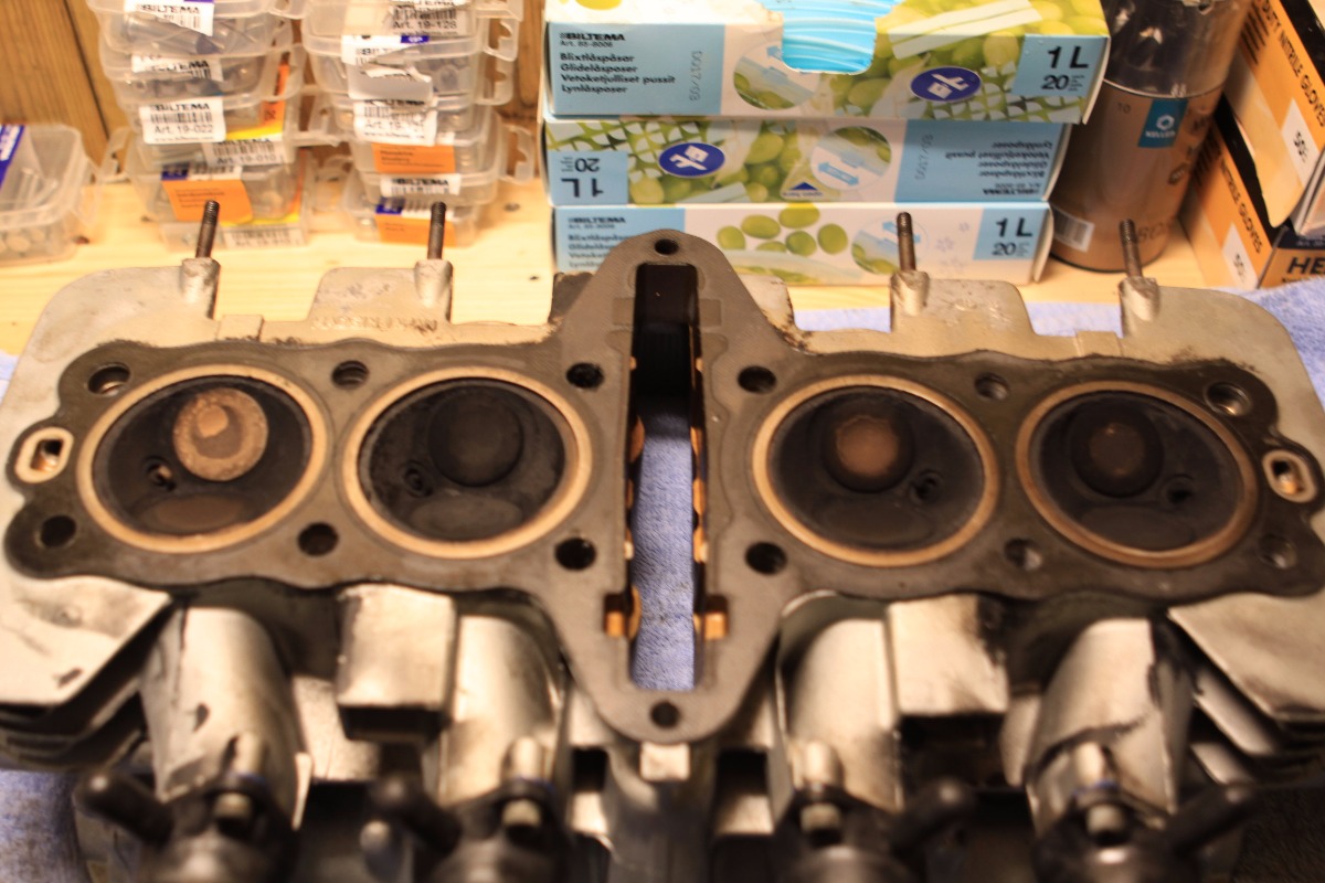

I would combine the two threads. It looks like moisture got into the cylinders judging by the staining. You could try a hone but chances are those bores will have to be bored. Try uploading pics using the attachment and add file buttons. The different color on the valves suggest the amount of oil getting past the rings.

Those cylinders look corrosion pitted where the rings parked on the cylinder wall. Most likely will need a bore job.

Looks like bad valve guide seals. A hone may do it but the stains go deep into the porous sleeves. If not pitted, they can be reused maybe. Better to get a good used set of barrels and change the rings. Check the condition of the valves guides and seats. May be able to lap them maybe again.
