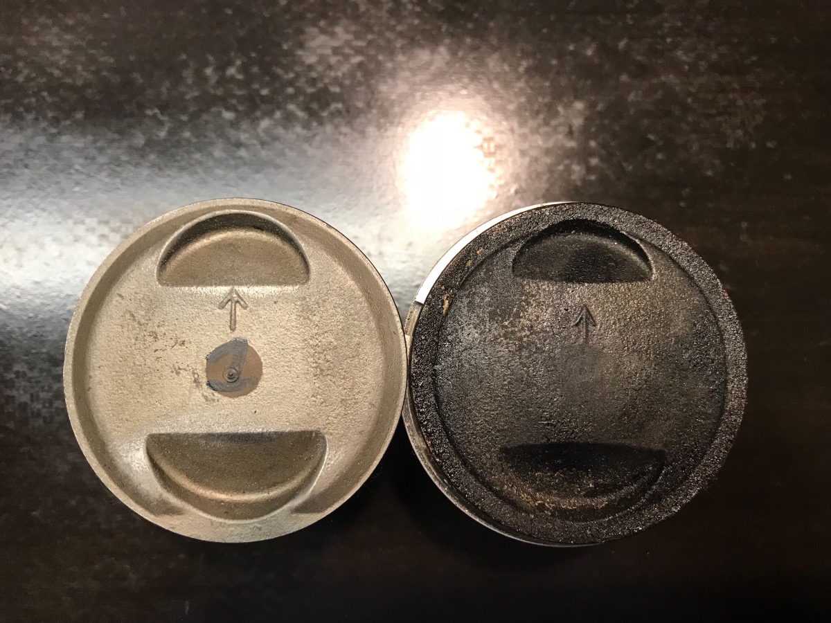

I did the 84–86 gpz550 (zx550a1) cam and piston swap in my zr550.
The cams bolt right in with just readjusting the valve lash to match the “new” cams. The base circles are the same, so no valve trimming is required.
But....the kz/zr550 has 9.5:1 compression ratio and the zx550 has 10:1.
(The kz550’s and zr550 use the exact same piston. )
This can be seen by the slightly raised dome on the zx550 pistons.
The zx550 on the left and zr550 on the right.
This .5 bump in compression combined with the higher lift and duration cams is what gives the zx550 roughly 15 more horsepower and 5lbs more torque.
But.... zx550 pistons have an intake valve pocket that is roughly ~1.25mm deeper than the zr550. (I neglected to measure the exhaust pocket.). So it may not be safe to put in the zx550 cams in the Zephyr without also changing the pistons as well. There is a possibility of the valves smacking the pistons at high revs.
That is what I did on mine as I was afraid of the valves colliding with pistons due to the increased lift, plus I wanted the extra little bump in compression.
It was worth all the effort and it pulls all the way into the redline. Definitly worth it if you need to take apart the top end to do a valve job.
EDIT: The 81-83 gpz550 also has 10:1 compression, but the pistons only share a part number for those 3 years. Which means that in 84 they redesigned the pistons with deeper valve pockets for the corresponding higher lift cams. So beware of buying gpz pistons that are not specifically advertised as being from a 84-86 zx550.
Hope this helps.

The discussion below does not really affect the Zr550, but I thought I'd post it for anyone interested, or on the odd chance someone can actually confirm the swap. As Tyrell mentioned, it definitely works with the 9.5:1 motors (-1121 pistons).
With many discussions on the Gpz550 forum, the one combination we have not confirmed was the Zx550A (3-groove marks) camshafts as a drop-in swap on a Kz550 D or H (81-83 gpz550) motor (-1127 pistons). Those motors, as mentioned, also have 10:1 compression, but the valve pockets are not as deep, and likely the dome is lower compared to the Zx550A (-1166 pistons).
But there is another factor involved, and that is the timing. The Zx550A has the intake camshaft advanced through the use of different holes on the intake sprocket. The sprocket is the same casting as all other Kz550 sprockets, but it has two extra holes drilled in what would otherwise be blank panels on the sprocket wall. One of the extra holes eliminates the Kz550 intake timing mark, you can probably get a decent estimate of where the mark would be.
So then the question becomes... does the piston need larger pockets because the cam duration is longer (maximum lobe lift is about the same or even a hair lower), or are the pockets larger to accommodate the change in timing?
Another question is, are both pockets indeed deeper? The intake likely is, but is the exhaust? Since there is a higher dome to make up volume lost in the intake pocket, does it just make the exhaust pocket look deeper, or is it actually deeper (than a Kz550 D/H gpz piston)? The Zx guys seem to stick with Zx motors and the Kz guys seem to stick with Kz motors, so no one has really done a very precise, side-by-side comparison, that I know of.
If the pockets are bigger due to the timing change, then it may be safe to use Zx550-Gpz cams in a KZ550-Gpz motor, as long as you use the standard Kz timing, which, if I recall, is what Corey recommends anyway... that is, using Zx550 cams but use Kz550 valve timing. I'd like him to confirm that, though.

I have no idea why that intake timing was given to the A Model, but this intake cam change works better. Gary Bishop actually turned me on to that, and I like it.
As for the ZX Cams in the D and H Model Engines, there should be ample piston to valve clearance. I don't think the added lift or duration is that much of a difference. Mark (Zaddict) and I will find this out when we do the cam swap.
