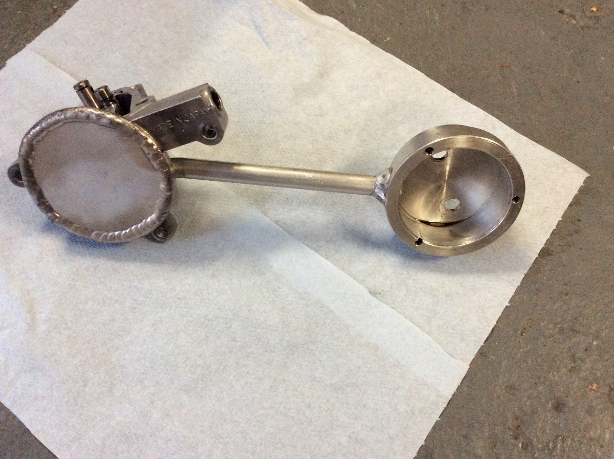

I don't know if it makes a difference but my oil strainer has been modified so it sits in the middle of the sump for obvious racing reasons. Then again if it was starvation surely it would be in a terrible mess after a few laps racing.
I don't know what to do. If the cams can be saved and I swap to shim under(which I'd rather not do really),I need to be confident it won't happen again.

I've seen them on the Moriwaki site but I ain't paying £300 or whatever it is,robbing gets!
I was going to trace round the cover on a piece of mdf and keep filing/cutting/adjusting till it was right,transfer to 6-8mm ally,blue the pushrod for a witness mark and drill and cut for a master cylinder..

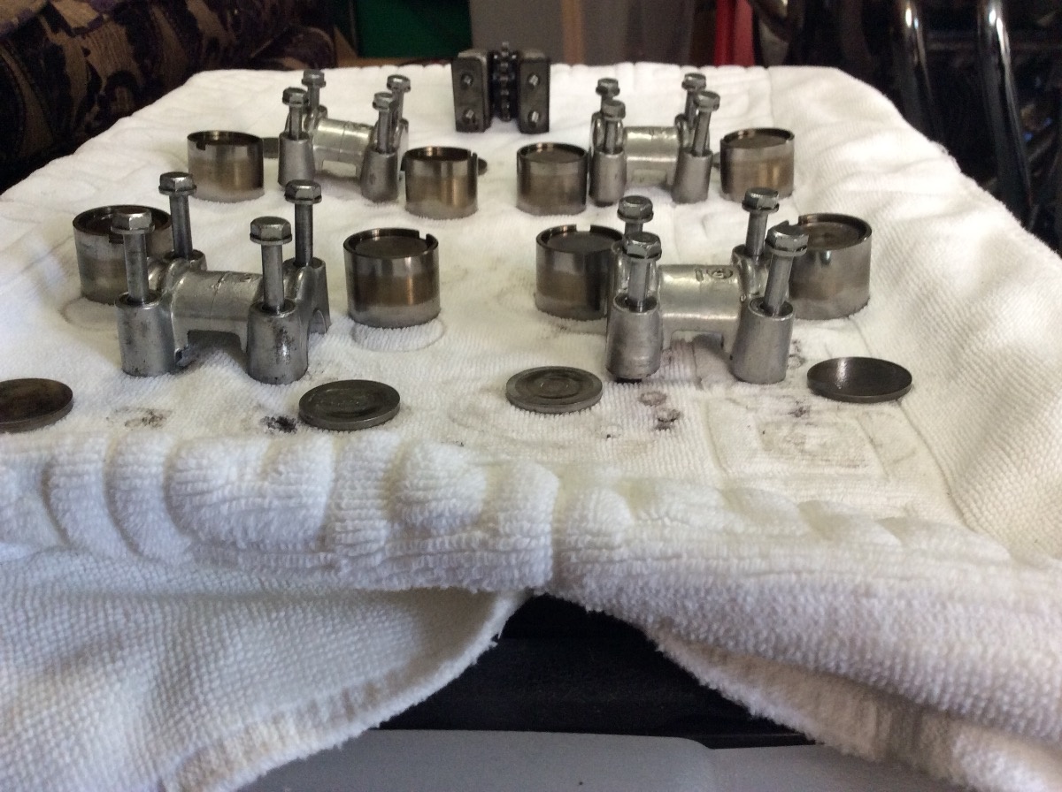

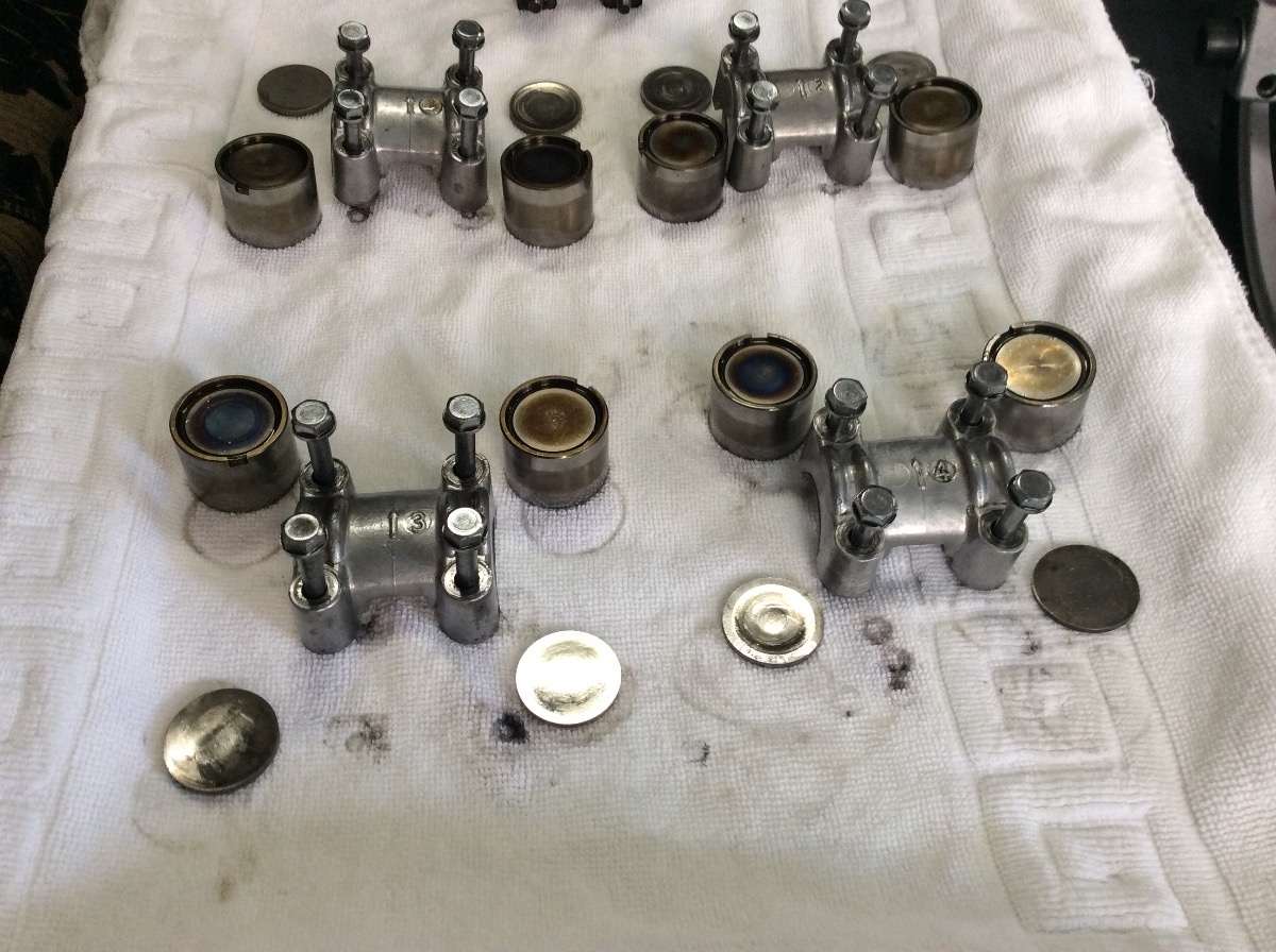

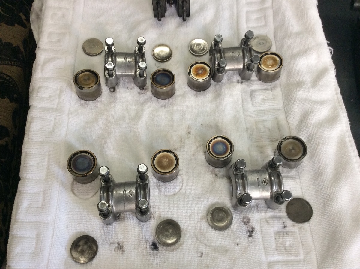

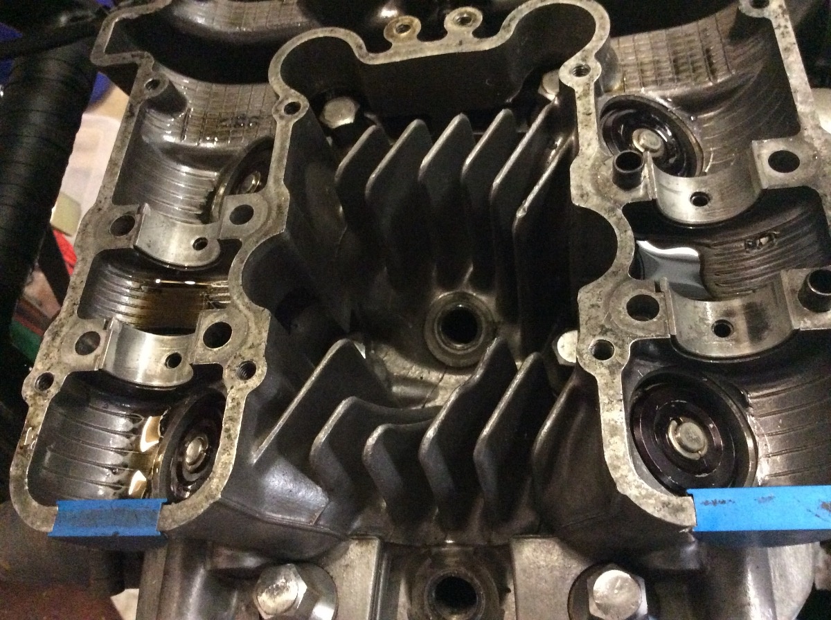

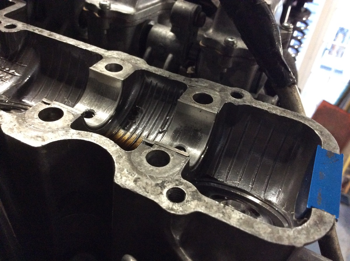

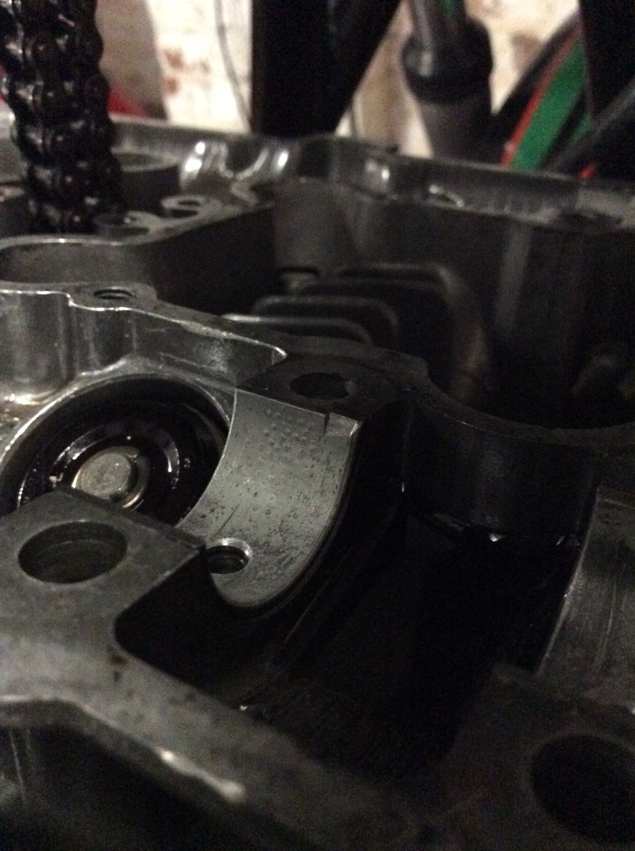

So I've sent my cams off to Newman cams,I've been told they can weld and re-grind so that's a relief.
He reckons by the look of them oil starvation is the problem. See pics below,click pic for full view.

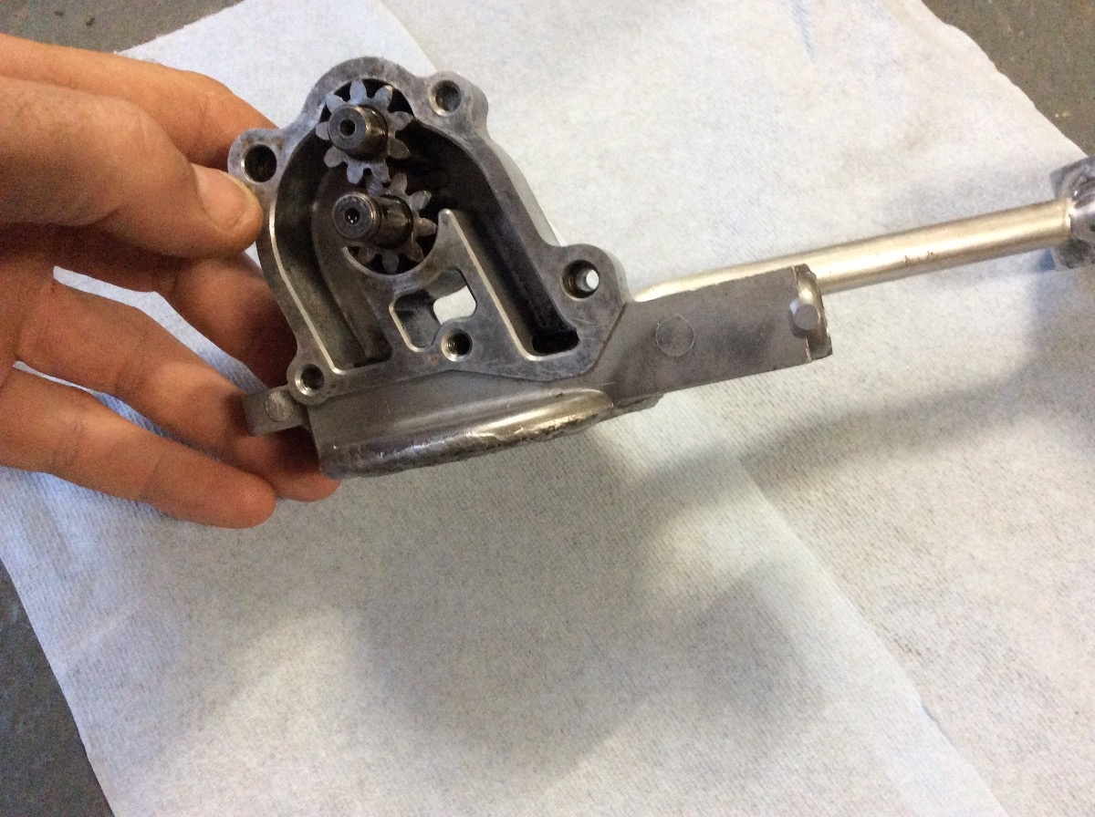

What's the procedure for checking the oil pump?
Anything else I should be looking for?

Oil starvation? Cam bearings looking good.
I would say some shims have lost the surface hardness why ever.
It could be someone grit them down to get the correct valve clearance or poor hardening process of the manufacturer.

Oil pumps rarely give trouble.
Early ones (with the screw on strainer) could suffer from air locks and the cure was to drill a tiny hole at the highest point on the body , this is well documented in most good manuals which you should get if you not have one already.
Look for radial wear on the pump cover plate where the gears have been rubbing, this can usually be lapped out.
The manual gives a clearance figure for the gears. This is between the tips of the gears and the pump body and measured with a feeler gauge.
Any Z1/900/1000 pump is the same so maybe a newer less worn one would be the easier cure if yours is very bad.
The Later pumps from the non kickstart J/GPZ motors also fit but have a pressure release valve fitted on the body though which needs unscrewing and the threaded hole blanking off.
The earlier motors have the valve installed in the actual crankcase whereas the J/GPZ does not.
The condition of the cam shells and valve buckets look normal and indicate a decent oil supply otherwise the shell bearing surface would be torn to shreds and the bucket skirts blued..
Most of the shims look dished and knackered though.
Early shims were prone to dishing and cracking so maybe a combination of that and possibly poor grade oil have effected the lobes.
I've had some race cams with the same flats as you describe and just put it down to harsh race condition wear.
Last edit: 15 Sep 2017 09:23 by zed1015.

I've had the oil pump apart,all seems well,3 thou between gear and pump body. The gasket doesn't look like it has ever been changed,
There is no wear inside the pump body. I'm worried to just put it back together and race again though. The shims were brand new before the last meeting,they've done 40 miles!!
Will you pm me your number please zed for a chat?
I've attached pics of the pump and a closer look at a couple of cam shells.

I'm just thinking about air locks now,my strainer is held on with 3 posidrive screws. I imagine this was taken off the original mounting point which then had a plate welded on,then the race mod with the tube to the centralised strainer was added and the screen with the 3 screws was simply re-used in its new position. Could it be that when I add the engine oil an air lock occurs in the modified pipe before the oil pump gears get a chance to pump the oil?
Moving forward I ought to leave the battery disconnected and turn the engine over on my pit starter so the oil gets a chance to get round.
