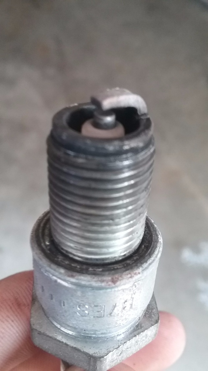

I tested compression on my bike (83 KZ1100, unknown miles) and I got:
1. 80lbs
2. 61 lbs
3. 60 lbs, but I couldn't get the adapter to thread in far on this one
4. 87 lbs
Can a bike run well on such low compression? Did I not test it correctly? The bike isn't running so its cold, I did open the throttle all the way up and turn it over until the needle stopped. I'm using a harbor freight tester.
Story:

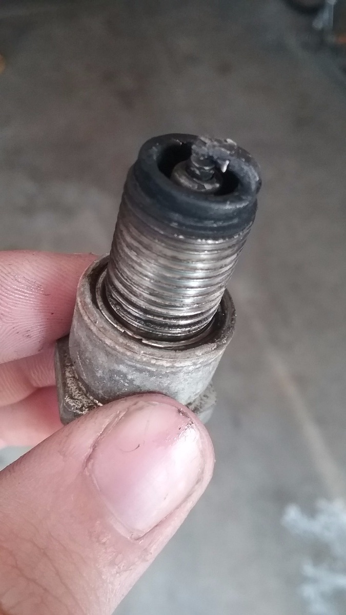

I was running to Lowe's and after pulling out of the parking lot and getting up to speed, I lost power. It would barely maintain speed. I got stopped at a red light and it died. It restarted once, but sounded terrible and didn't have any power still. I had it towed home, I pulled the spark plugs and cylinders 2, 3, and 4 looked fine (top picture). Number 1 is the bottom picture
I put in new spark plugs, then decided before running it to turn it over by hand, just to make sure I didn't jump timing(I didn't actually check timing I wanted to make sure it would turn over without hitting valves) or something. I turned it over and one of the cylinders started hissing. I assumed I blew the head gasket or a valve wasn't seating on cylinder 1 based on the spark plug. Either way I checked compression and thats what I got and I don't understand it.

Is there a piece of metal imbedded in the side electrode in the lower pic? Based on what I can see, I bet something really bad happened in that cylinder.
The following user(s) said Thank You: M_a_t_t

TexasKZ:
No its just part of the spark plug flaking off. Comparing it to a spark plug color chart, it looks like it overheated.
