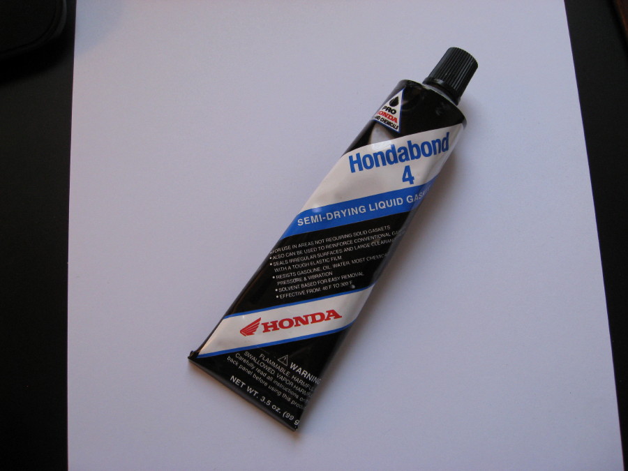

You may want to use Hondabond 4. It will prevent leakage but is not a permanent adhesive. I've used it where a non-permanent sealant is called for and never had a leak. Ed

I picked up some Yamabond 4 too..... thinking its pretty much the same as Honda's stuff and should last a couple times if your careful. What ever the factory used was good stuff I never had a drip for 30 years even though I had the cover off 6-7 times at least. And for the gasket it lasted that long without leaking or tearing too.... just be gentle taping it to free it up and off. (A trace of grease on the cover will keep it from sticking there and staying on the head).
