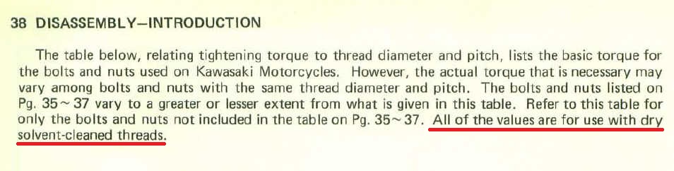

The first comments I expect to get are that the torque specifications do not match the factory specifications. If you prefer to use the factory specs, please feel free to do so. My specifications are based on the fact that most of these motors are in the vicinity of 40 years old. Some of my specs are lower than the factory manual because I have had to repair thousands of damaged bolt holes.

Now I'm confused.
You state: "Any time a bolt is installed, the threads and the shoulder of the bolt should be lubricated with oil. There are two reasons for this. First, it allows for the applied torque to be correct. Without lubrication, the applied torque can vary widely from the intended value. Second is to prevent damage due to scoring of the threads on either the bolt or the threaded bolt hole. Lubricating the shoulder of the bolt accomplishes the same purpose in that spot."
But the Kawasaki Service Manual States:
Can you help me understand the discrepancy?
Thanks,
Thanks,

Like I said, if you want to use the manual, feel free.
My procedure is based on 43 years of experience and hundreds of motors assembled.
I never said that any other procedure is wrong, I am just offering mine.
The use of these instructions is up to the user.

I would not oil the bolts. They will be over torque if FSM specs are followed. You procedure is very thorough otherwise. The case bolts and fasteners over 6mm will likely not have a problem with over torque (10 to 15% when wet), any smaller could strip the aluminium threads. R

joehooper wrote: "Ed - Like I said, if you want to use the manual, feel free.
The use of these instructions is up to the user. "
I don't at all doubt the success you've had using your method, and your method may be considerably better than that described in the manual. I was only trying to understand if there was an explanation as to the different approaches.
Maybe there is a difference in the torque values used. Do you use the torque tables from the manuals or some other reference? Also, do you tend to torque to the low, middle, or high end of the torque ranges specified?
Thanks,
Thanks,

Anybody who doesn't believe torqued bolts should not be lubricated has not worked with stainless steel hardware.

Not sure what you mean. Regardless of material you will have to alter torque values by -10-15% if you use lubed hardware. These Kaw bikes have pretty soft aluminum. Steel or SS will strip the aluminum threads with too much torque. Lube em all ya want if you compensate for torque or eventually the smaller fasteners will be stripped. I know plenty of folks that never use a torque wrench with fine results, but I rely of proper measures of torque when I work on a motor. 2 each their own. R

The only thing I would suggest as an addition to this topic would be to toss the 8mm crank bolts, stock cylinder studs, head nuts and washers in the trash. I replace that old crap with heavy duty fasteners on every engine I build from the bottom up.
I have had the 8mm crank bolts snap off during tear down. Why run the risk of having one snap during assembly.

Just had that happen to me. I wish I had used anti seize at least when I put it together in 13.

I just finished assembling my engine this week. I would also recommend neverseize on everything. Taking it apart I broke one of the crankcase bolts and one of the small 10MM bolts. Tried mig weding washer and nut, tried heat and finally drilled and retapped both.
I wish i would of read the post earlier as I had to remove the oil pan to see why the kickstarter was not disengaging. Finally figured that when the arm on the bendix is bottomed out on the stop, that is when the return spring is installed with the tension on it. interesting enough the reason I split the cases was to replace the stop for the kickstarter. it had broken off the tab and i can not figure how this can ever be possible. I think the previous owner may have realized something was wrong when he sold it. When i split the engine, never did find the piece of broken tab. Seems to look good now ,so I should find out when i get it all together. Take care- Chris 78 KZ 1000

I wish I could afford to toss all the large bolts. I'll at least be chasing the bolt threads and using oil on the bolts this time.
