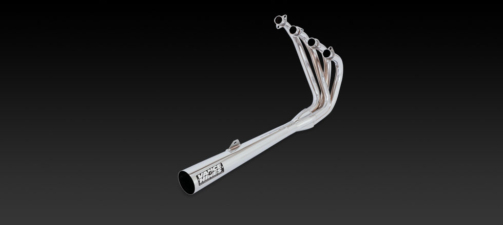

I guess V&H should know, but it's hard to see any real restriction in the shape of the road exhaust. It probably depends how highly tuned your motor is as to whether it makes any real world difference and I would also suspect the difference is at the highest of rpms.

With the system I bought the two other baffles for it. Those baffles fit both style exhaust systems. I suspect is has to do with the length of the pipe after the collector. Back pressure/scavenging? I've noticed modern systems have longer runs and smaller mufflers.
