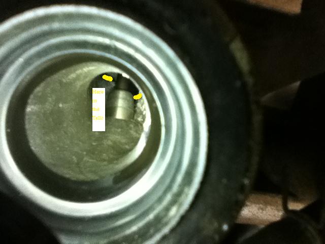

Here are some pictures that I took of my intake valves. 3 of the 4 looked fine but the valve lifter and the valve rod itself look pretty beat up. Any ideas on what's going on here? I still haven't had a chance to get a good compression tester but I was able to temporarily put the carbs back on without the throttle cables plugged in and was able to get the engine started with some starter fluid and the engine seemed to run file on idle. Of course, I'm still working on cleaning/tuning my carbs and replacing the stuck float valve.

In the top picture, it looks like something might be in the port right up on the valve seat. Looking at the picture, there is some sharp edges around what should be the base of the valve seat. There at the Yellow shaded areas.

If things changed after you did your hand move, then something went into the motor or something moved, that was already in there.
Try to fish it out. Opening the motor is a can of worms for a novice.
