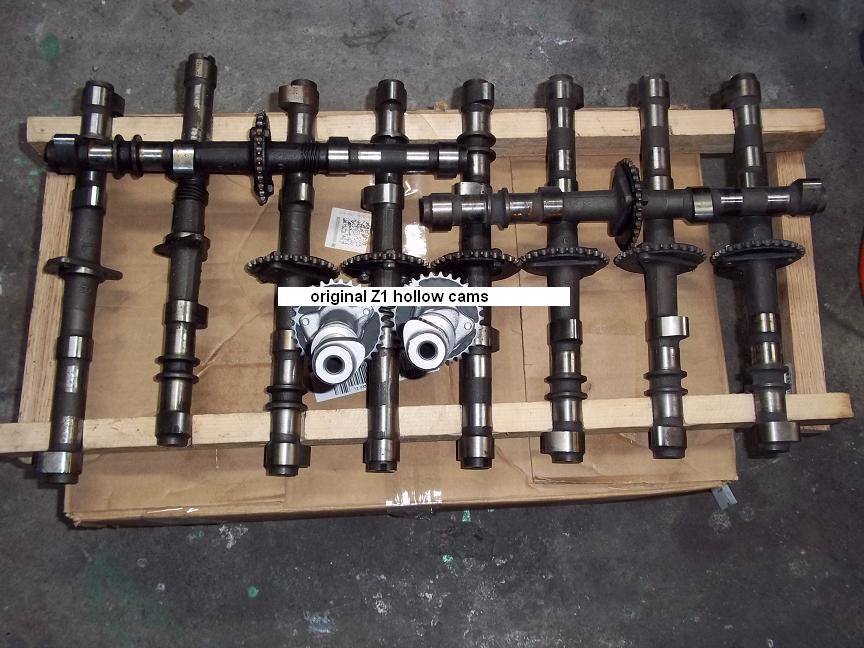

Re: Removing Camshaft Sprockets
27 Feb 2012 22:45
