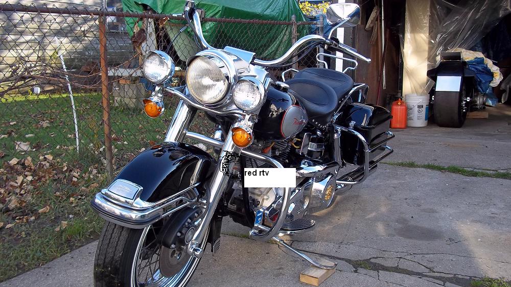

Double That! RTV works great! Hi Temp Red, is what I use. I never had an exhaust gasket on my old Harley's pipes in 25 years. You can see it on the front pipe orange-red ouze.
Excuse the HD for those who don't like.
