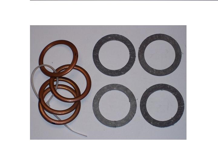

I just want to take my exhaust of and paint it. Do I have to replace the copper exhaust gaskets? Or can I get away with reusing them? I have a ride this weekend and don't have time to get new ones.

replace them ,save the headaches B)

If you don't, they'll leak.

You can ANNNEAL them but always better to replace for all they cost.

I have a lot of used ones and I just heat them cherry red and dunk them in water and double them up. I'm cheap. Roy

I have some, that are so old, they are asbestos!! :woohoo:
Must have been in the aftermarket old gasket kits they sold in the late 70's

In a pinch, I have been able to remove the exhaust and put it back on without leaks. as long as the gaskets don't fall out (they usually have to be pried out), and you can get the pipe back exactly where it was. But it may take some luck.

martin_csr wrote: I could be wrong, but I don't believe annealing works w the header gaskets.
Aren't they hollow inside, so once flattened, they're done?
It did work for me 1 time on a ZX6R & they were hollow as well.
