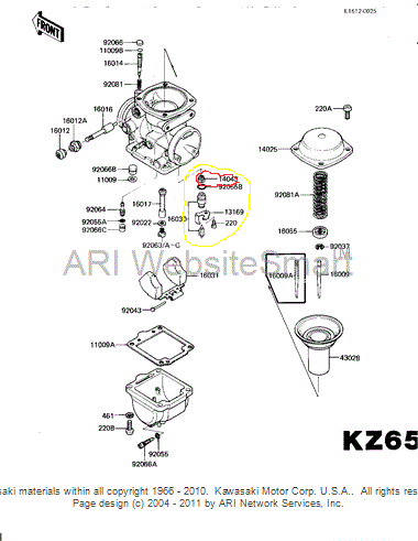

Those BS32 carbs will also have a screen at the fuel inlet, to the float valve, just above the needle and seat. These could be getting restricted.
