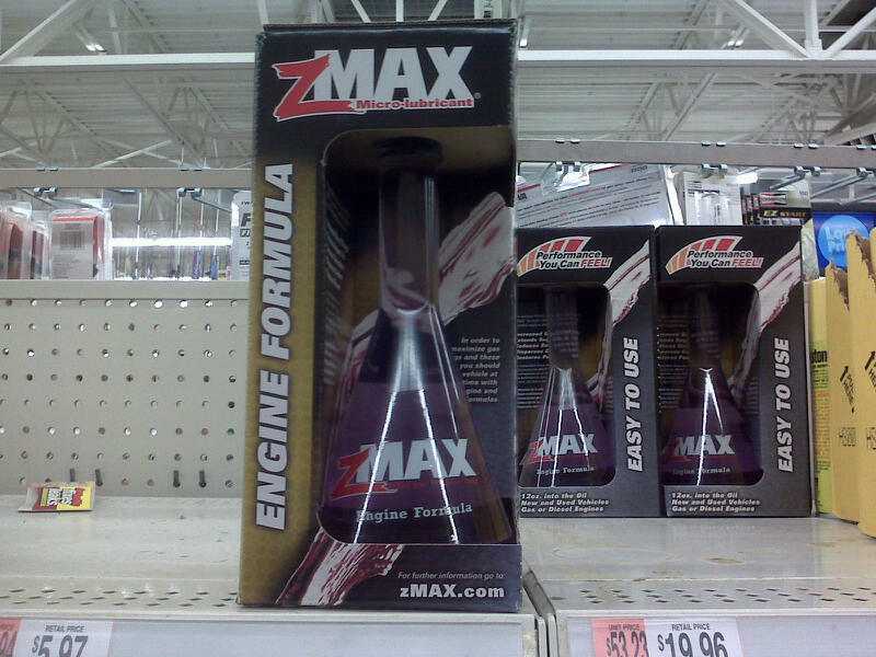

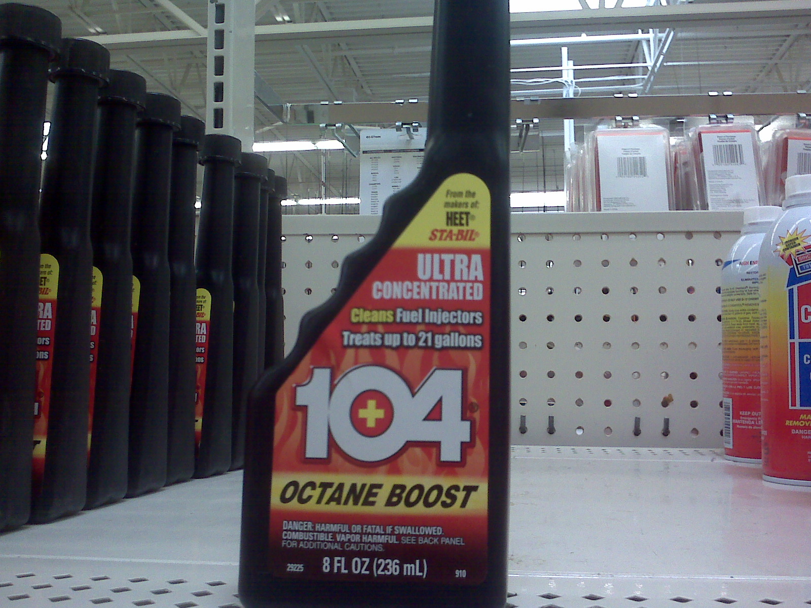

Re: What is the best oil for a 77 kz1000?
17 May 2011 18:48wireman wrote: alright i got my new amsoil catalog and dealer price list yesterday,so it must be the best! :woohoo:
Jim is a "Story Teller"... Jim runs this, cause he's Crazy Like That. :silly:
And when Jim is not feeling the Bike "On the Pipe" he Huffs some of this in the Tank. :whistle:

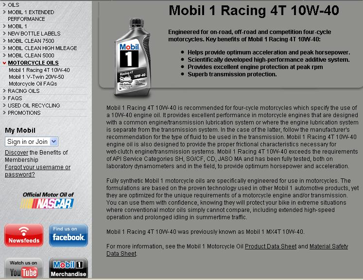

18 May 2011 06:53 - 18 May 2011 09:24
I can't speak for others but in my case where slightly modified performance build & AZ temps... Synthetic for my baby is the only way to go.... Sure, synthetic oil is additional $$$ but so is a blown engine. :pinch:
NOTE: Designed for WET (EDITED: CLUTCH :whistle: ) Engines....
KZR SEcret Police Watching/// Whoa! :laugh:

18 May 2011 07:56Old Man Rock wrote: NOTE: Designed for WET SUMP Engines....
Err...clutch, you mean? Aren't most "modern" 4 strokes wet sump?
- Old Man Rock
- Posts: 6073
- Thanks: 225
18 May 2011 08:07 - 18 May 2011 08:07
If you prefer, WET CLUTCH.... :whistle: Tough crowd... :laugh:
By definition, still applies....
Engine sump/oil pump is the area below the crank shaft. In a wet sump, the oil that you put into the engine is stored beneath the crankshaft in the oil pan.
In a wet sump, the oil pump sucks oil from the bottom of the oil pan through a tube, and then pumps it to the rest of the engine.
In a dry sump, extra oil is stored in a tank outside the engine rather than in the oil pan.
Will that work for you guys....? :laugh:
